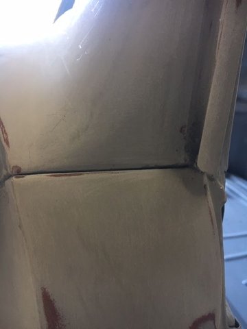

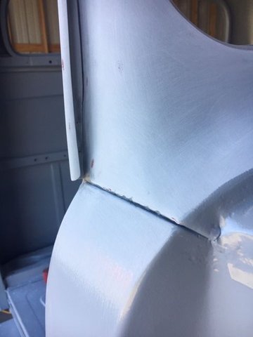

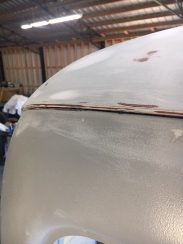

I am prepping cab for paint. I was wondering if anything goes in these seams on the exterior. What keeps the water from entering the seam? I don't think the exterior had seam sealer in them.
seam front of door, door
Back of cab above back window
front of door

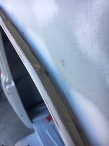

What about the top of the drip rail. What keeps water from getting behind the drip rails. I have read on this site the drip rails can be a problem.

Yes, there should be seam sealer installed in all of the places in question. There are several types, catalyzed and non-catalyzed. Check with your local auto body supply store and see what they recommend in your budget and desired work level. Some of the 2 part catalyzed types will need a special application gun. Many times the applicator is more expensive than the material, which still isn't cheap. If they don't have a gun to rent or borrow, some basic stuff in a tube, (Kent, 3M, etc) will work just fine. It's old school, but they worked for many years.

I use 3M 08308 heavy-bodied seam sealer in various locations on the body, it works exceptionally well in the drip rail channel. A 200 ml cartridge can be purchased for less than $30 on ebay. The applicator is a costly needed tool but right now there is one on ebay as well for about half of the retail price https://www.ebay.com/itm/3M-08571-Ma...kAAOSwZEJdtb1A.

This is a catalyzed product, it sets in about 15 minutes and cures in 24 hours When cured it has the consistency of hard rubber, think hockey puck, and can be sanded easily. When I seal my drip rail channels I use a popsicle stick to smooth it out, when cured it has a smooth shiny finish and only needs a light scuffing with a gray scotchbrite pad before painting.
