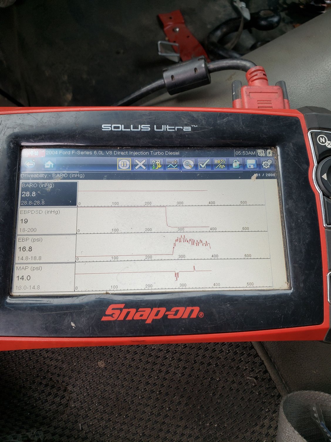

Photobucket no longer supports videos. And the attachment is an mp4 which is unsupported by the attachments here. Anyone know a way around this?
On edit:
https://youtu.be/5j_4FzU9UpM
Old Nov 10, 2019 | 07:41 AM
BRay09's Avatar
BRay09
Joined: Oct 2008
Posts: 2,308
From: Elyria, OH
KOEO
Cold start. KOER
Power braking when noise starts from turbo
Old Nov 10, 2019 | 07:50 AM
bismic's Avatar
bismic
Joined: Nov 2003
Posts: 27,924
Likes: 3,644
In the third link - EP desired is 120 in HG. That is 58 psi. Your EBP reading is 27.8 psi. Something sounds off there.
Old Nov 10, 2019 | 08:25 AM
BRay09's Avatar
BRay09
Joined: Oct 2008
Posts: 2,308
From: Elyria, OH
Koeo shows 200 inHG desired I thought the same thing. But just dont know where to look. I have my other 6.0 all torn apart and can't really compare. Even if they are different, where should I be looking?
