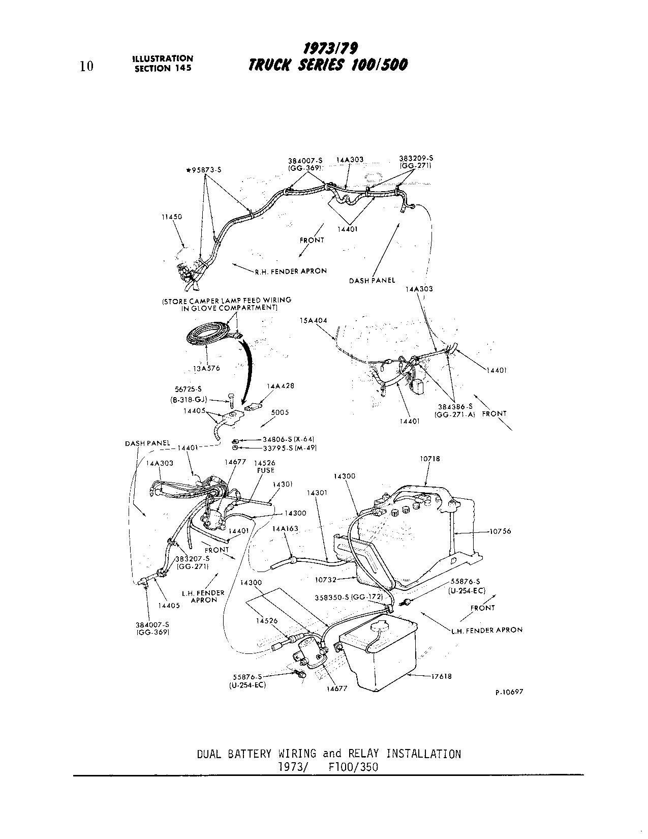

Old Oct 26, 2019 | 01:12 PM
NumberDummy's Avatar
NumberDummy
Ford Parts Specialist
Posts: 88,826
Likes: 785
From: Simi Valley, CA
Dual batteries were introduced in 1973 F100/350 as an option.
Upper (upper) pic and lower pic:
