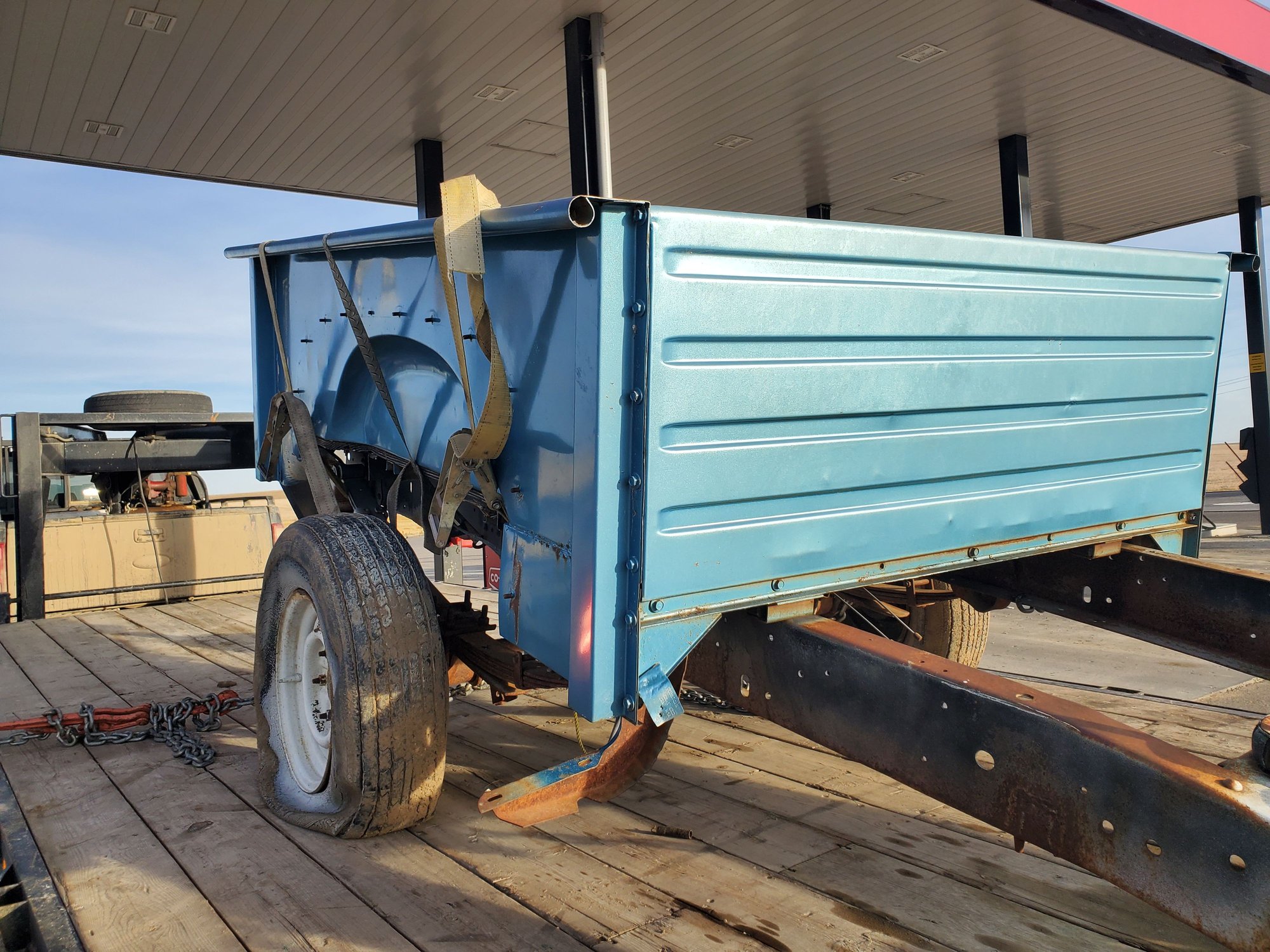

Kinda, sorta. I stumbled upon a mint flareside short box for $500 while looking for a replacement fleet side 8' box.
My sides and cross rails are beyond pooched. For what ever reason my cab and front end are in excellent condition.
So now I have plans to build a short wheelbase. While cutting the frame is an option, I was searching for a SWB frame before I started down that path. I had found a striped down the SWB from an earlier model 4wd.
