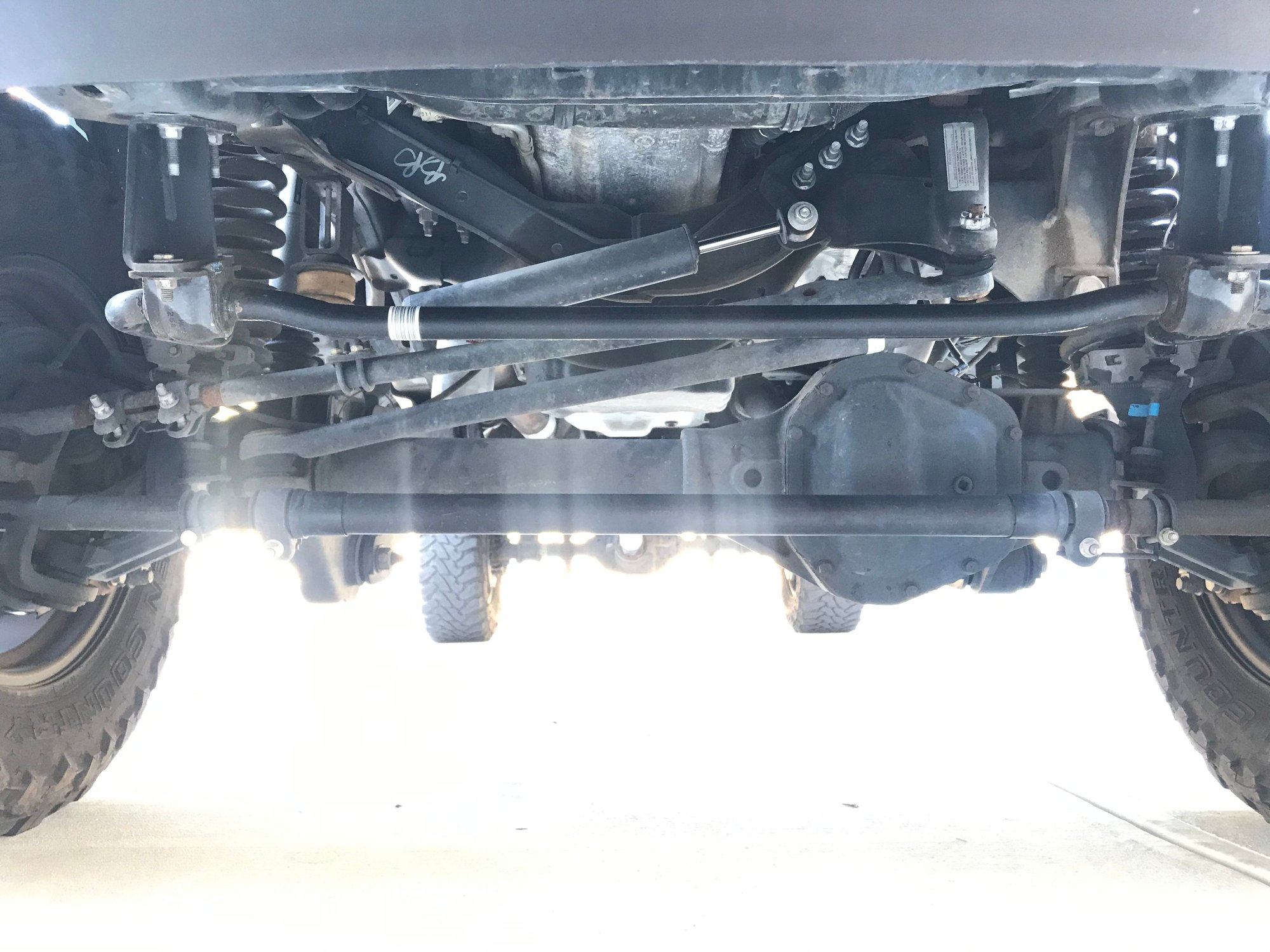

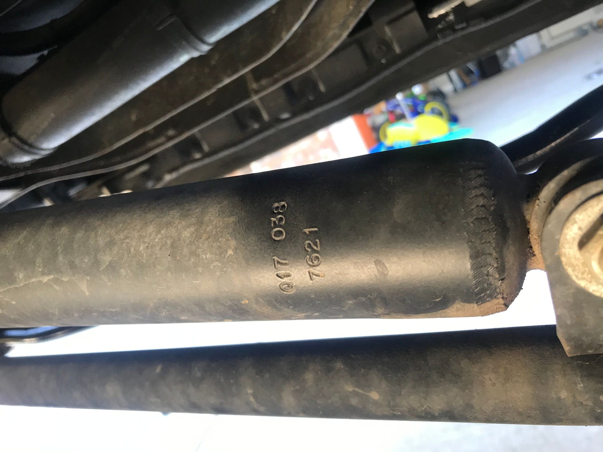

Omg there is a bunch of BS (pun intended) in this thread. the Internet is full of advice and most of it is sadly inaccurate. 17oaks has no idea what he is talking about.
The position of the steering wheel is adjusted at the tie rod, has nothing to do with bump steer.
Bump steer is effected by the angle and length of the tie rod in relation to the track bar. The only other variable is the steering Stab shock.
First realize a solid front axle will always have a degree of bump steer. It’s inherent to the design.
OP your steering Stab is the source of your choice exaggerated bump steer. It cannot be at an angle like it is. At an angle it is inducing a degree of BS as it’s compressing WITH suspension travel and putting input back into your steering. Stock the Stab sits level. Your need to address your setup so it sits level to the ground so it’s only function is to dampen left/right movement and not be inputting it’s own feedback as suspension articulates
seems you know what your talking about. would you agree the SS would be in a better location had it been attached at the steering knuckle to the axle housing, rather than drag link to frame ?

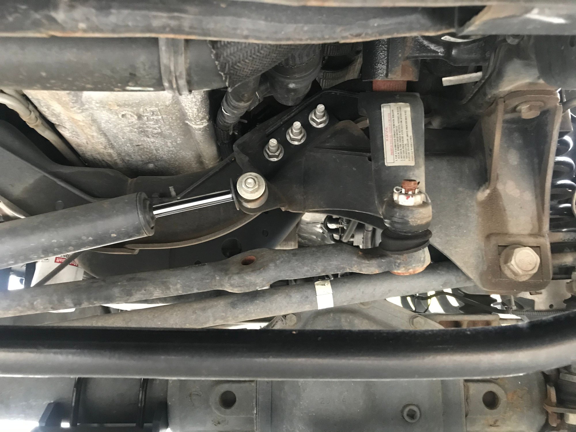

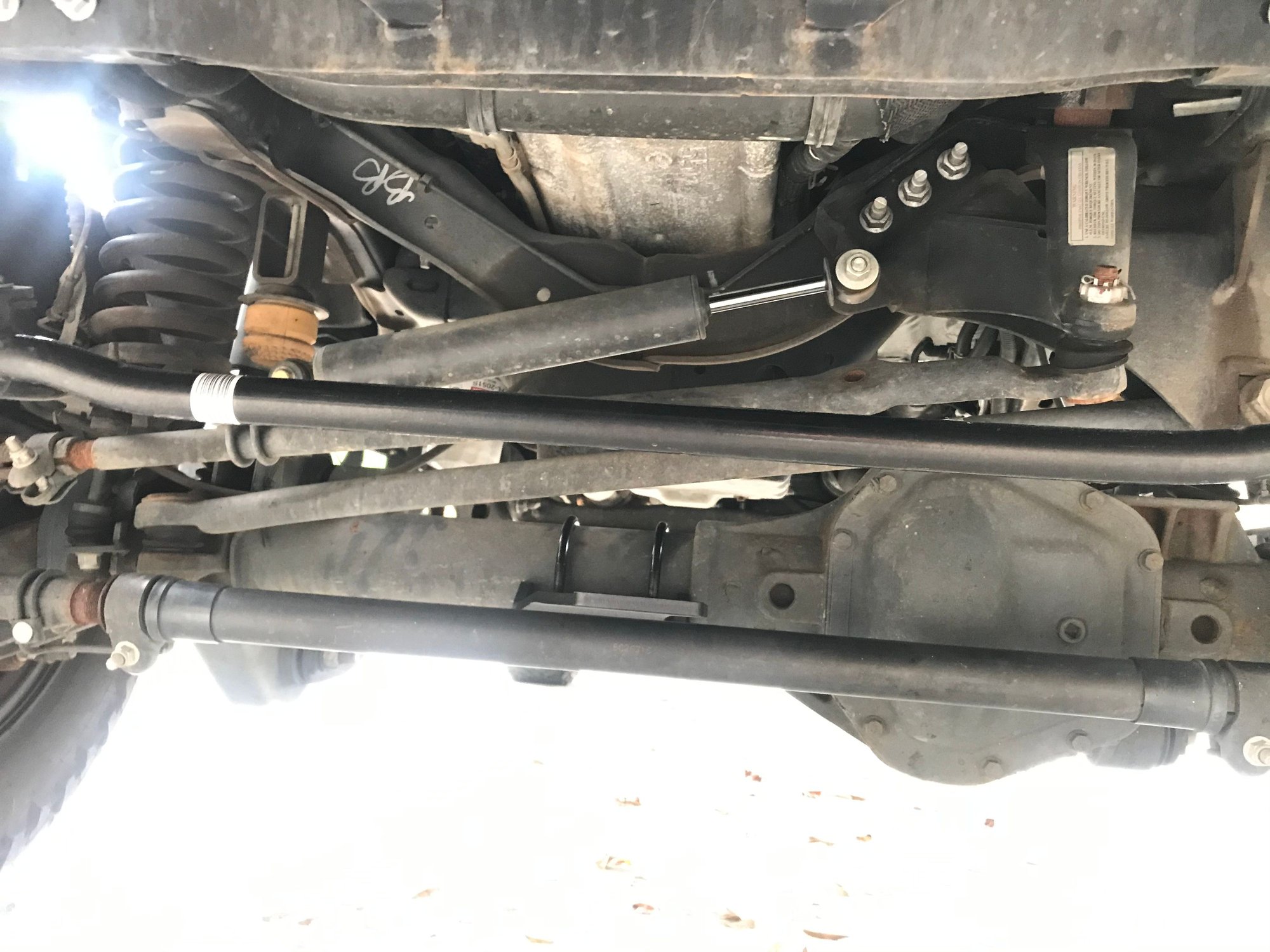

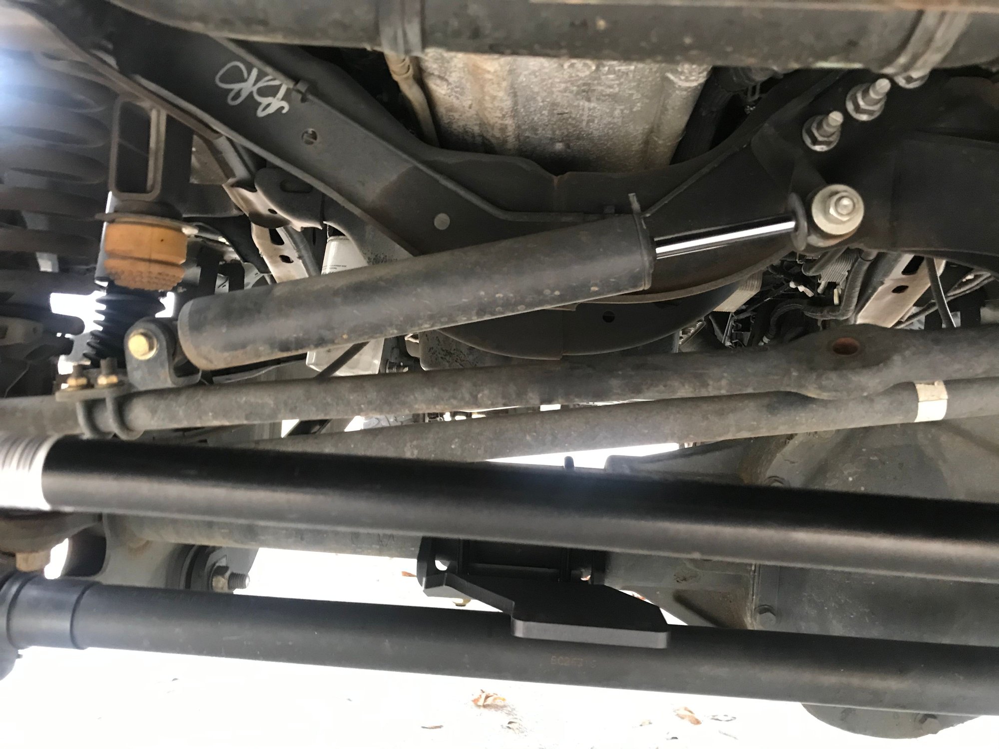

Looking at your pic it appears the Trackbar and Draglink are parallel within reason. That said do you have a pic of the Pittman arm where it is attached to the Draglink? I cannot see the Pittman arm in your pic?
How much lift do you have?
Here is one the ones I built, 3 in lift/37 tires no BS or DW.
The top bar is the drag link,then the Trackbar, then the SS, then the Tie Rod. Note everything is parallel to each other and the axle, also note the SS is attached to the axle-Tie Rod
Red arrow points to the track bar, note the parallel suspension to each other and the axle.

thank you for the detailed response. I plan to find a quality alignment shop next week and see what they say,.
it’s a 6” lift. I attached more pictures with drop pitman ask.
