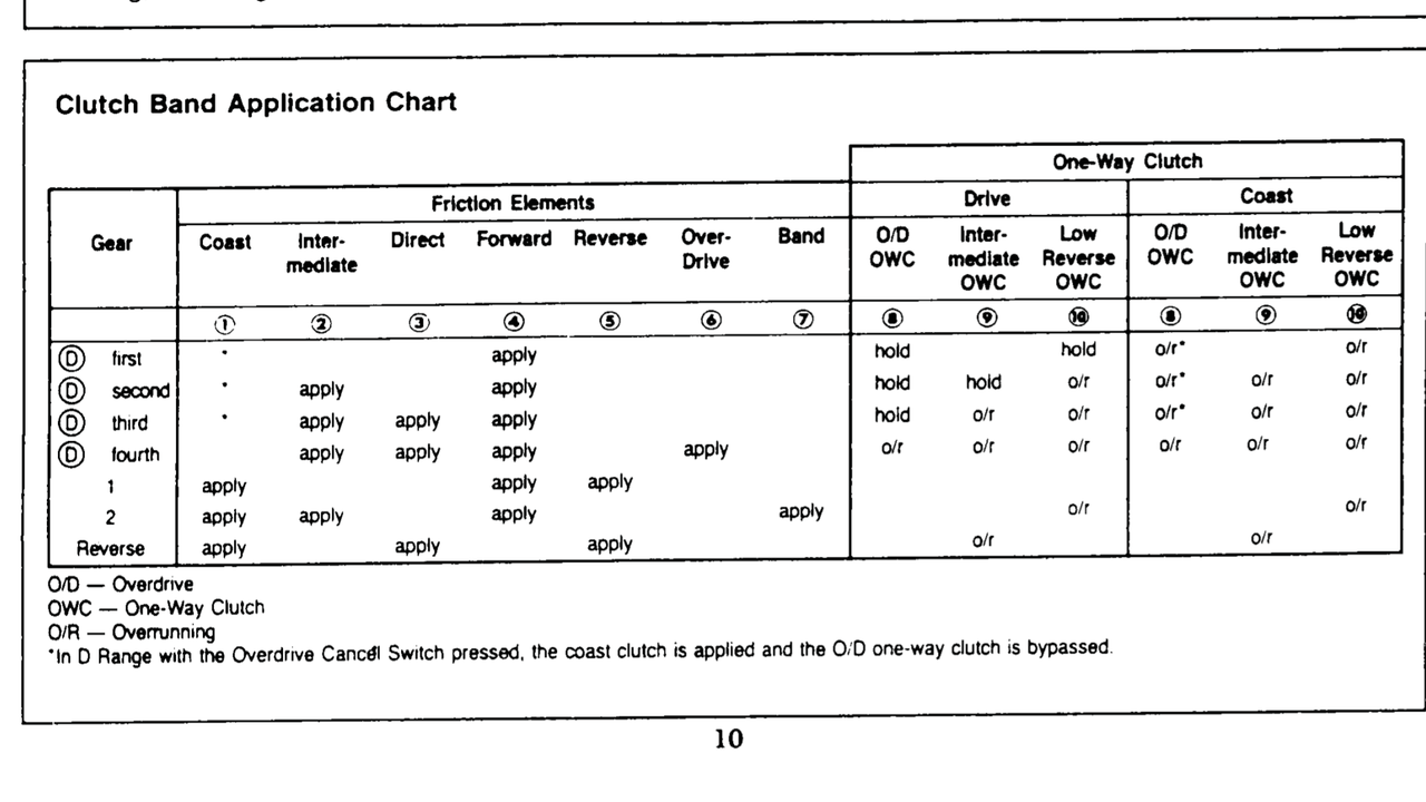

Sounds like it might be tear down time. The reverse clutch is applied in M1 and reverse, but a problem with it shouldn't keep M1 from working,the way I see it.
Anyway here's the clutch,band, and one way clutch chart:
