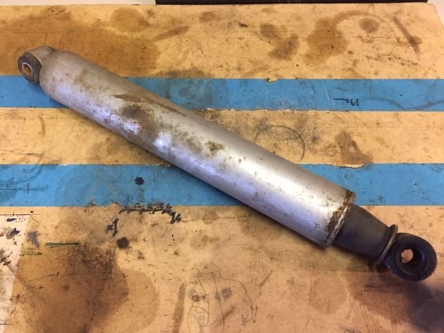

Ok! Got my new shock bushing from RockAuto yesterday...
And got the shocks off today... but... won't bother putting new bushes in... perhaps I need new shocks? lol
Zero pressure on all of them.. they stay in any position you like: fully extended, fully close, half extended... you choose. lol

My experience is that's how hydraulic shocks work. The key is there needs to be resistance when they move, if they move easily or are leaking they should be replaced.
Nitrogen charged shocks will expand on their own. If that's what you have and they aren't expanding then yes, replace.

I believe they are hydraulics, as I bought the truck not long ago. There is almost no resistance compressing, but a fair amount of resistance extending. And one of them is leaking.
Will probably look for options now, from Bilstein or FOX IPF.
