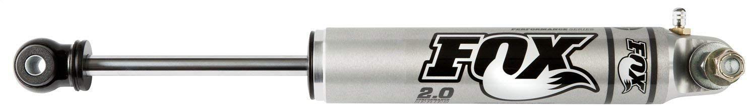

This morning I hit a bridge joint and the bump steer lasted for a good bit so I ordered a Fox steering stabilizer. Hopefully it will fix my issues.
I have the stabilizer with DSC and it is a noticable improvement, I think the biggest change is caused by the polyurethane bushings, since they are stiffer, and that improves the steering feedback.
I will say that with the firmer settings, the return to center takes longer and the truck will tend to wander on a straight section of hwy. Annoying by my standards.

A good steering stabilizer as stated above fixed my bumpsteer. It was horrible before.

Well I've had my new steering stabilizer installed for a few days now and it's amazing the difference it made. The steering feels like it did when the truck was new. Bump steer has reduced and effectively reduced the oscillations felt afterward. Crazy how loose the steering had gotten in only 11k miles and a year of ownership.

Swapped out SS and there was a noticeable difference in BS IMO....

I just installed the 2.0 TS version. I saw an improvement too. I think there is a difference between bump steer and feeling bumps in the steering wheel. I definitely fell bumps in the wheel and sometimes they are pretty nasty. I don’t however, hit a bump and have the truck change direction and require corrective action to keep it straight. That’s my definition of bump steer.

Did the exact upgrade on my 2019 250 with 11k Miles. Same results as above.

Whenever I would hit a bump the truck would be thrown off course but would also go into a low frequency high amplitude oscillation that could be felt heavily in the steering wheel. After replacing the steering stabilizer I have yet to experience either again.

So is the correct part number 985-24-001 for the single ?

I went with the Dual Rancho and my bump steer was totally eliminated, no more wandering or bump steer in the slightest. I actually left the stock one in place to see what the difference would be and I am really impressed with the steering now.
