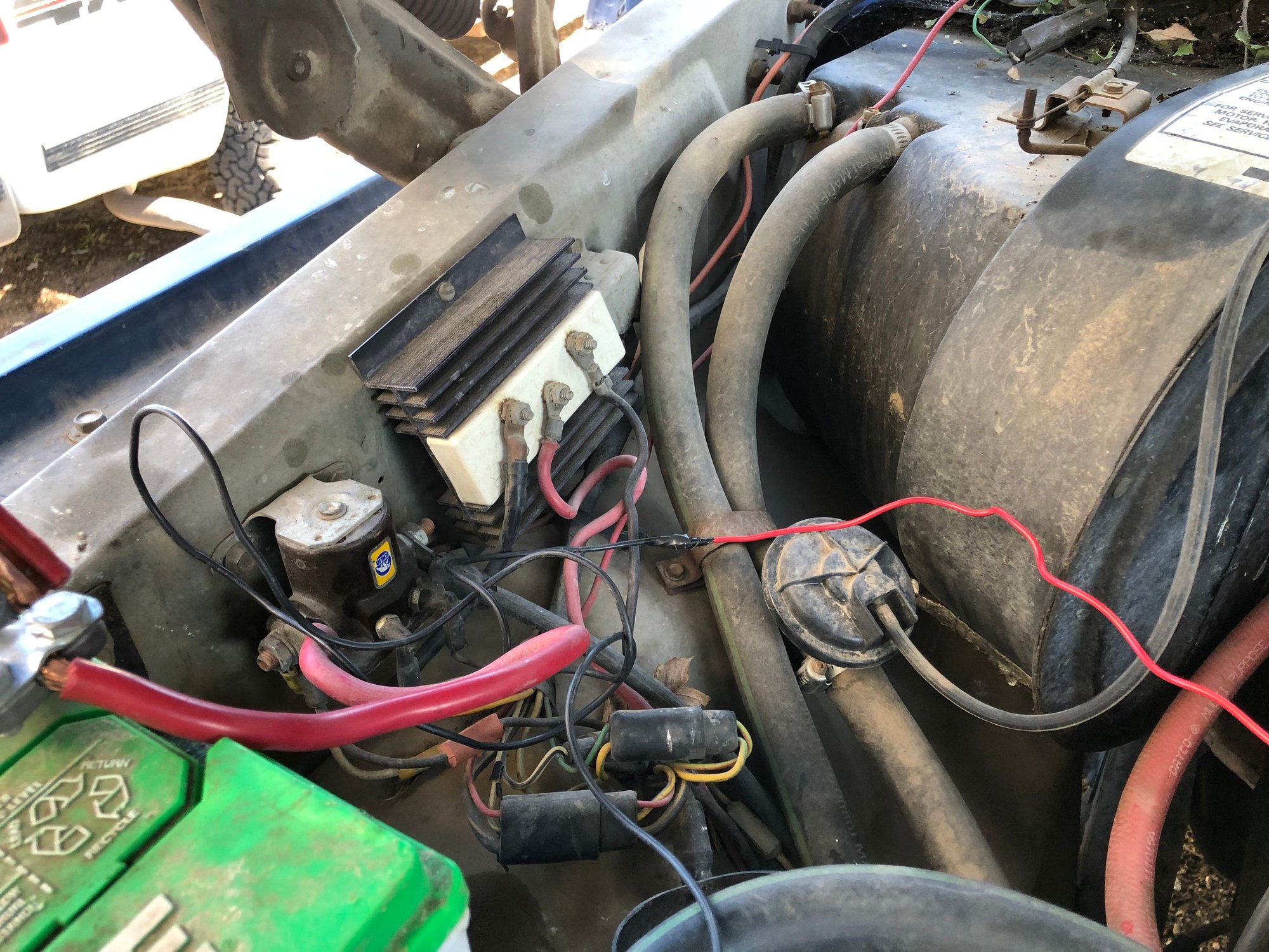

Is this factory?
I’m not sure if ford put battery isolators on duel battery trucks or if this was added. I’m only running single battery now. Should the other set of cables have power with no battery? It has a parasitic drain on the battery and I didn’t know if this could cause it. I don’t know much about wiring or how to test for it but battery will drain in a few days and at the time it was a new interstate battery. I unhook the stereo and the cd changer in it but it still drains. The trucks a 1977 F250 super cab 460 engine. It has block heater and what I was told a factory winter cover for the grill. Would ford put duel battery in it or was that a camper special option only.

Does not have a factory look imo.
I have an aftermarket isolator that looks similar.

I'm not sure that Ford ever made a battery Isolator....all the motorhomes that I have seen used Aftermarket Isolators... and I wouldn't think Ford would mount one with a Common Head screw ... it's not conducive to production work.
Battery Isolators are used to separate batteries from the system ie one battery for the engine and accessories, the other for House Loads like in a camper..

Would it cause a drain battery? The cables lay on the extra battery mount tray and no sparks or fire so I don’t know if it is working

Battery isolater is not FoMoCo related.
Pic: 1973/79 F100/350 with factory installed dual batteries.

I’m sorry was there no isolator on fords?

^ This 'black and white box' with the 3 connected wires is not a FoMoCo related part.
I posted a pic of the factory dual battery schematic, do you see this box there? No you don't and neither does anyone else, because it's not a Ford part.
It may have been installed by an RV dealer.
all a Battery Isolator is ... is a pair of Diodes...
You can test it with your Multimeter......

Thank you sir. I’m sorry I go stupid retard on it like I said I know nothing. I really appreciate your help and knowledge I wish I knew as much as you forgot. Wiring diagram make feel stupid and don’t anything.

I didn't mean to CornFuse you with schematics that you don't understand.....
perhaps this video will Help.. all they are is 2 doides back to back....
IF either diode fails then yes it can cause the Aux or the main battery to drain.
