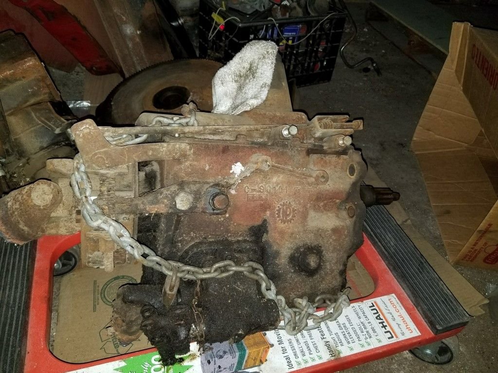

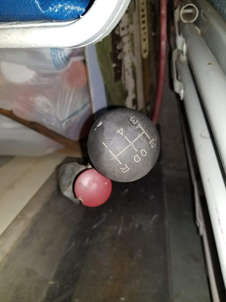

NP= "New Process" 5 speed shifter lever ****
NP 5 speed transmission casting number
Originally Posted by P350
Hey thanks for the reply! I will get thoes pictures posted tomorrow certainly. That's exactly the type of info i am looking for. Well the trans is on the floor so im assuming it might be the t-98. Its pretty awesome to get to research this project. Thanks for the information!
I own one of those 5 speed transmissions it was in my parts truck...it now sits on a piano dolly with me deciding if I want to put it into my tool truck when I do a clutch....the tool truck presently has the 4 speed Borg Warner T98...Your 5 speed is going to be a NP which stands for "New Process" that is the companies name...I have no other information other than parts are not really available for that transmission..Some were non syncro in ALL gears if I remember correctly requiring double clutching...since this was probably added by someone along the way its not likely to be a completely non syncro transmission....1st gear wont have any syncros though......my info is a little fuzzy now I was researching it almost 2years ago now when I broke down the 1955 C 600 COE it was in...that parts truck is pieces now...but is being transformed into a resto mod using a 2002 E550 with 7.3 powerstroke diesel....

@mytoolman Thanks for the pictures. Did NP also make this transmission with 4th in the foreward position and 5 th to the rear? In our two corresponding pictures of the shift *** the pattern on 4th and 5th (Overdrive in your pic) are flip flopped. Also if mine is a new process 5 speed as stated and no parts are available can i still get a new clutch for it or is that the problem you are running across? My clutch seems soft. Haha guess im gonna have to brush up on my double clutching ability! Currently im rebuilding the heads as i have 4 stuck valves and the matching pushrods were bent. Good thing tho is that i pulled the heads and found that the cylinders were bored 40 over! Im hoping Its got a mild cam. The heads look like they have been machined as well. It seems that it went to the shop then all the old parts were thrown back on for whatever reason. One of the cylinders looks like it hasnt even been fired. Checked spark and sure enough there was none to that cylinder. I got lucky with this one i think...
