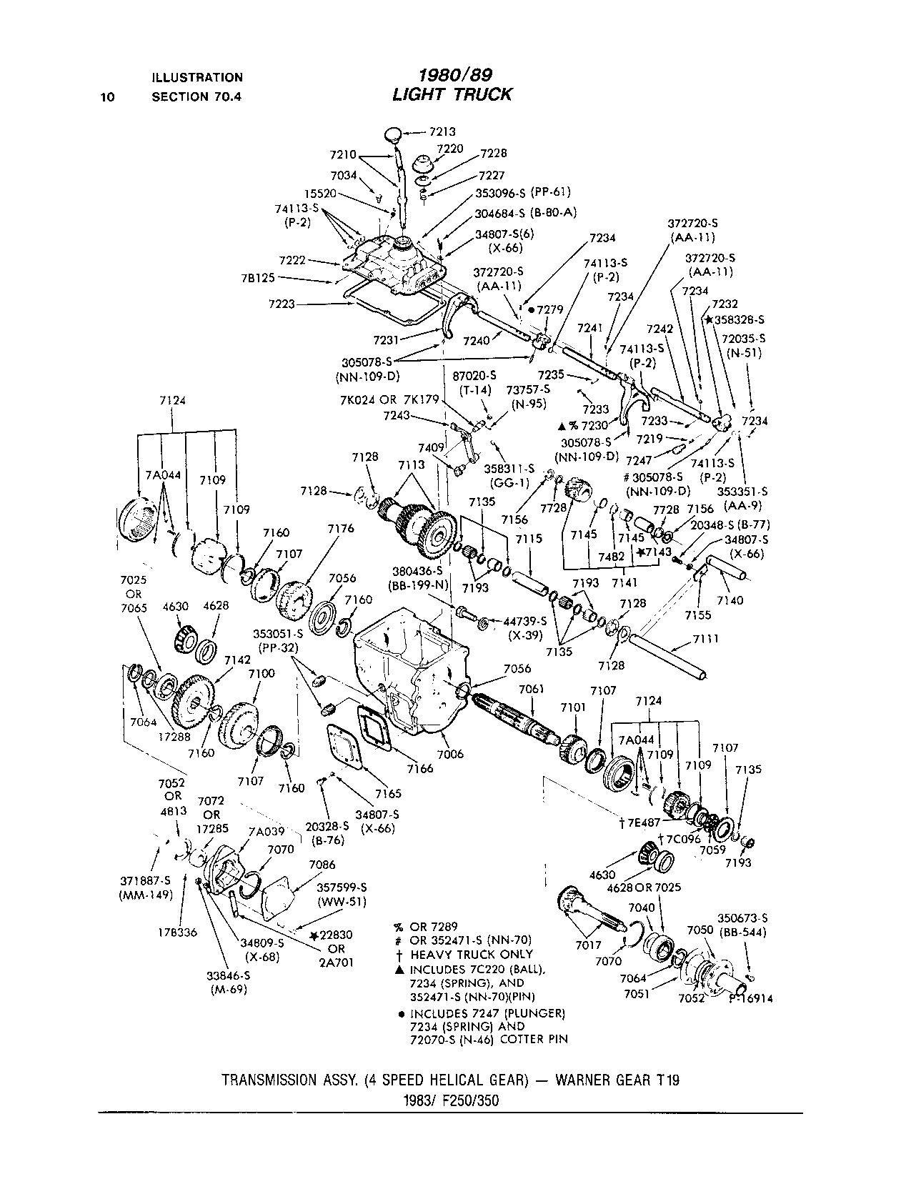

Old Oct 9, 2019 | 10:59 PM
h.ubk's Avatar
h.ubk
Joined: Aug 2019
Posts: 115
Thanks for the diagram. In just eyeballing the transmission and shift housing, I'm just doubting if there is any room to pull the shift housing without the whole transmission.
