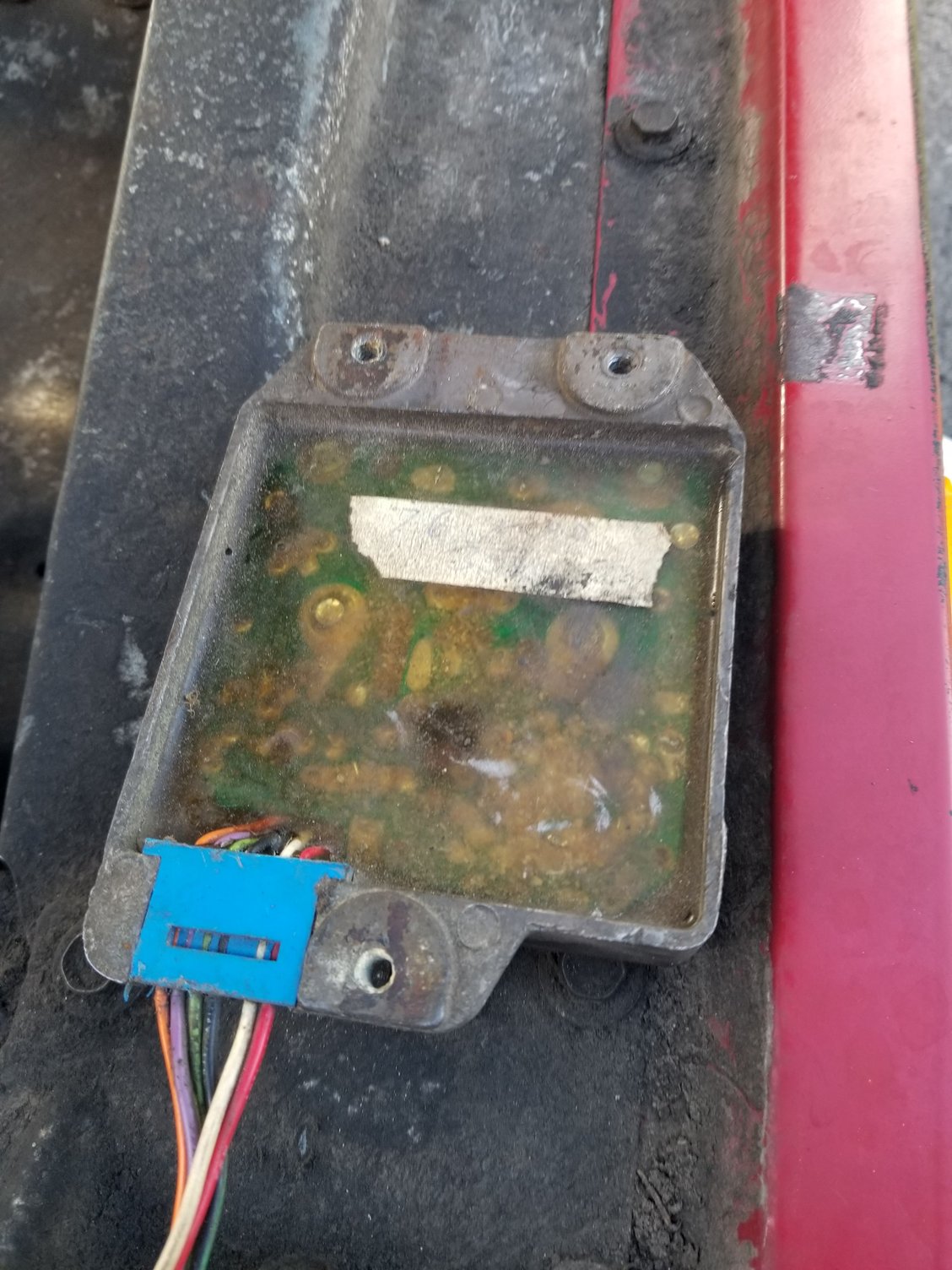

Took the truck (79 F150 2wd 351M auto) out for a spin a week or so ago. Came to a stop light about 5 miles from home and it just quit. No sputtering or noise, just died. Cranked it over and it started right up so continued on my way. A little farther on it quit again. Took a few extra cranks this time but it fired up. Turned around and took it home. It did not quit on the way home. Thought it might have been a little bad fuel.
Tried a few days later and it quit at the same intersection. Had a hard time starting it but it fired up just as the light turned green. I made my left turn and it quit again. Even harder to start this time. Took it home.
Today I swapped in my spare ignition control module (ICM). Everyone carries a spare, right?
That solved the problem, at least so it seams after taking it out for about a 10 mile drive. If I experience any more issues I will be back looking for help!
Here are some pics (cause I've been on here long enough to know y'all like yer pics).
Zip tied the new one to the tire iron for testing ...
New ICM installed:
Backside of old ICM:
Old connectors were in bad shapethe crud is old dielectric grease):
Now to pick up a genuine Motorcraft ICM to replace this aftermarket one which will return to being a spare.
1U2Z-12A199-AA (replaced D6AZ-12A199-A & B, D9VZ-12A199-A) .. Ignition Module - Blue Grommet (Motorcraft DY-893) / Available from Ford
1976/90's myriad FoMoCo vehicles.
If you can find a D9VZ-12A199-A (Motorcraft DY-184-C) NOS, you'll be better off. People have told me that this new 1U2Z module in made in China.
Thanks, Bill! I found a DY-184-C for a reasonable price.
