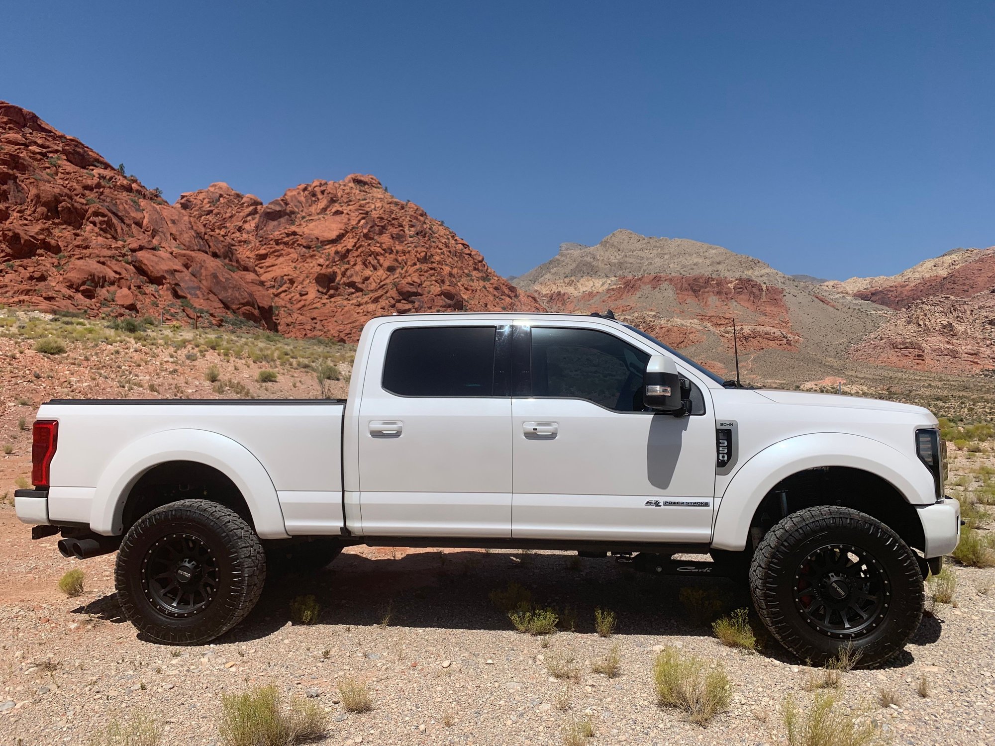

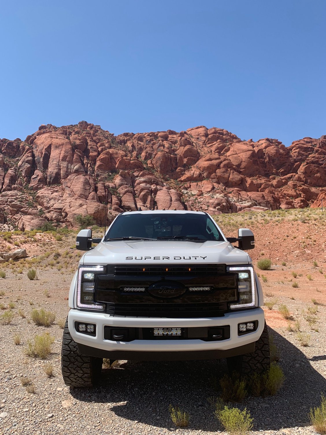

19 F350 6.7 with 3.55. Full Carli 4.5 pintop system with full rear leafs, airbags, PMF dual stabilizers, 37x13.5x20 Nitto Exo Graps with Wilwood brake upgrade. Just waiting on Carli torsion bar install and front Eaton Truetrac LSD to make it a more complete desert runner. Speedo corrected with Hypertech, pedal commander installed, 55 gallon tank.
1. Get about 14mpg in mixed city/highway. Towing my 9-10k trailer, get about 10mpg.
2. Don't notice any difference in towing handling-wise. It towed great before, tows great still. But I'm not hauling 30k goosenecks around.
3. The ride I feel is vastly superior to stock, but I've pretty much modded everything out with reputable components. I'm still waiting on Carli torsion bar install which should provide an even more supple ride. Overall more planted, more precise, more compliant with better control. Braking with the Wilwoods is seat of the pants better, but I don't have any metrics.
Will things wear out more quickly, potentially? Yes. That is the price we pay if we want to play. Granted, this is not a work truck, just a family and fun truck. This is also not a mall crawler, and is a blast to drive out in the sand... almost on par with the wife's Raptor - just different. Heavier truck, less nimble, slower steering, but still fun.
Go for the 37s. For some of us on here including myself, I think the truck looks right with the 37s. For those that don't like the look, that's fine too. Super Duty's are great trucks and look beautiful stock as well.

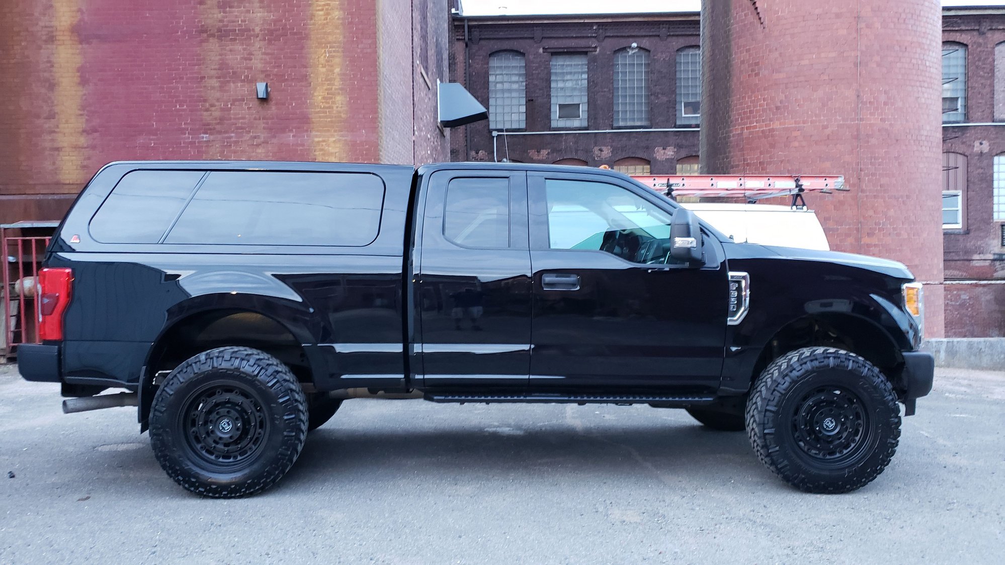

I don't notice a difference in anything from stock EXCEPT a softer ride.

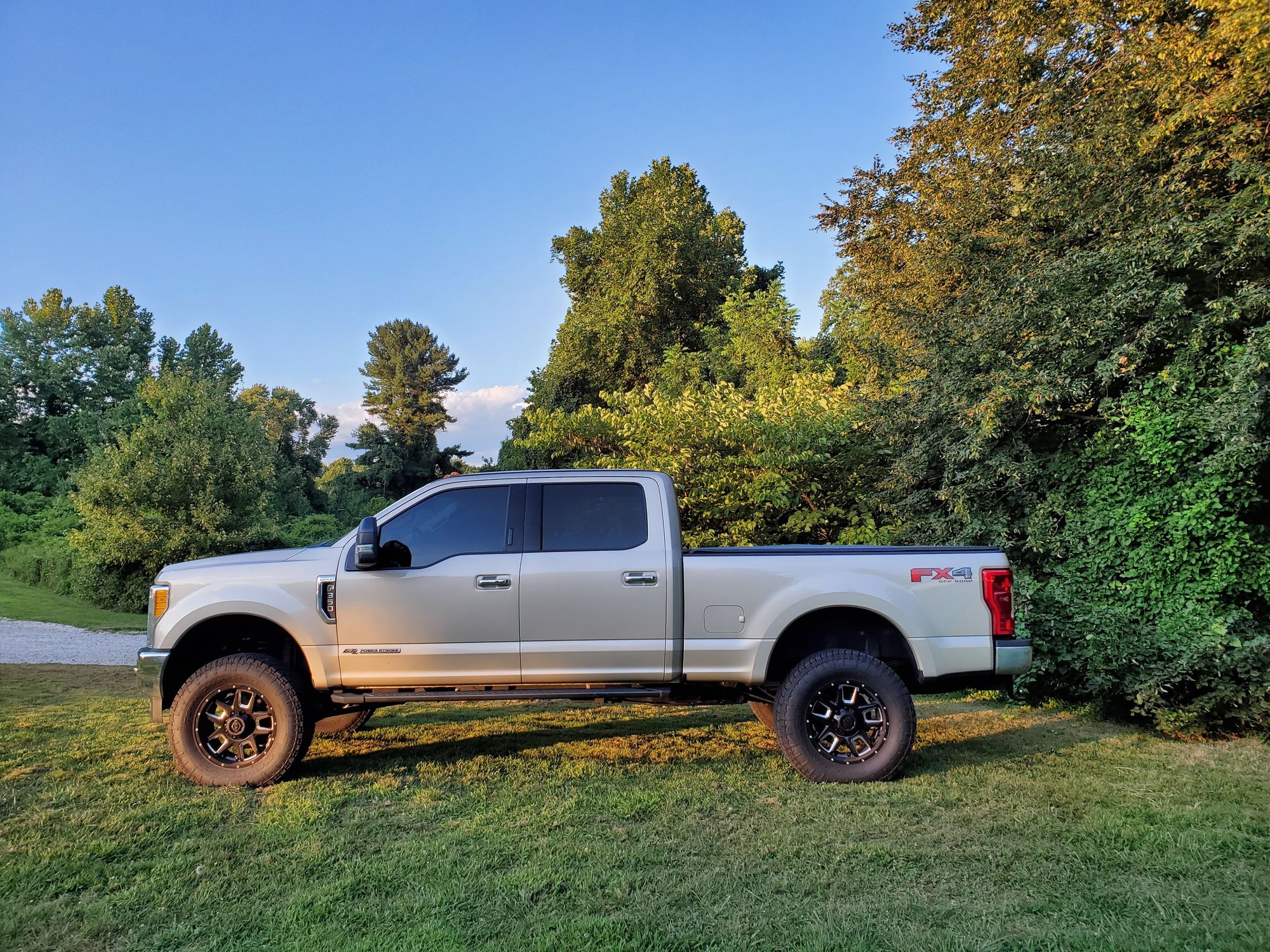

I have +18 Gear wheels and Nitto Terra Grapplers 37's. These tires are light, 10 to 15 lbs lighter than muds. I cannot notice any difference in drive-ability with this set up other than a littler more flex. I have the 6.7 and acceleration has not been negatively affected. The +18 sticks out just enough to offer a better look than stock but not enough to cause faster front end wear. My old set up was the 295/20 Ridge Grapplers.
