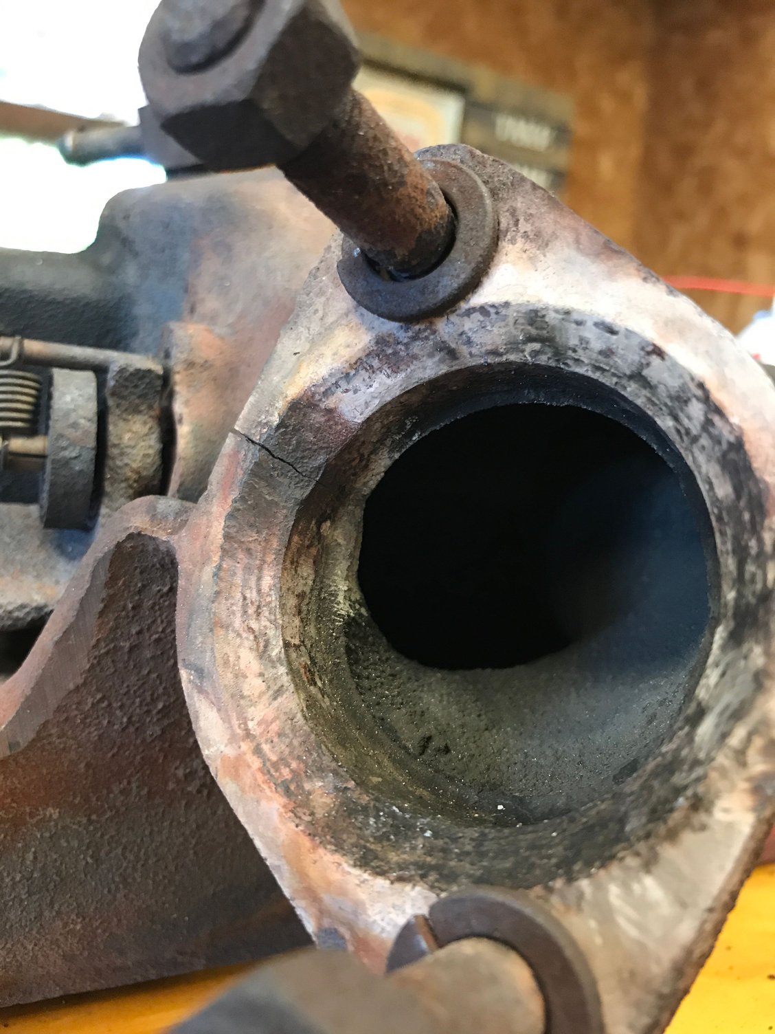

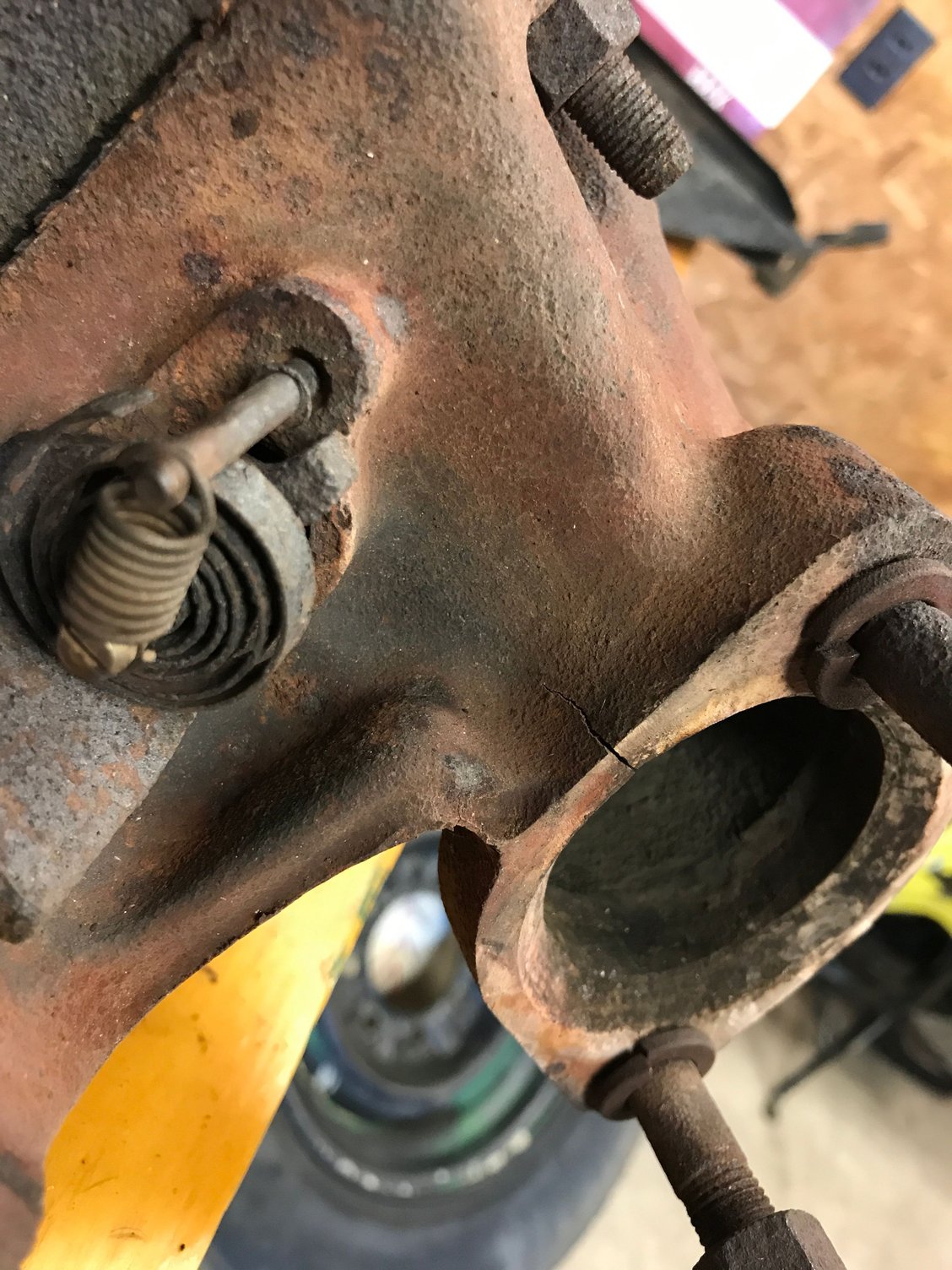

I was hoping to keep the truck stock but discovered this little booger, any thoughts on fixing vs replacing, I can do the fix myself, just didn’t know if this crack location could be saved

Someone over in the 80-86 truck area just had one fixed but his was where the manifold bolts to the intake gasket surface.
They welder heated up the manifold and brazed up the cracks but left the built up braze on the gasket area for him to file flat.
Another user the welder took the weld down in the same area to far turning the manifold to scrap.
Does the heat valve move & work? It looks like it could be leaking and why I asked.
What does a new one go for?

Unless you are experienced with welding cast iron, just replace it.
But if you do try to repair it. Drill a small hole all the way thru it where the crack ends. Doing this will keep the crack from spreading when you heat it or weld it. And if you do try to repair it, preheat the manifold before the repair and then you want to control the speed at which it cools down. If it cools off too quickly it will likely crack again. I've seen people use a BBQ grille to do this or even bury it in sand. You just want to do something to help keep the heat in the cast iron and allow it to slowly cool down.

It is repairable...…. cast iron must be heated (entire area) before the welder begins welding the crack and then it must cool slowly.....meaning the welder must either heliarc it or use a oxy-acet torch..... anyone who knows how to weld using this equipment is a real welder...… and will know what and how to do it. Very commonplace with even home-welders up through the 70's
