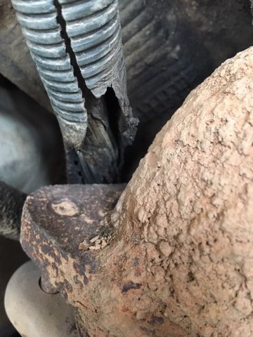

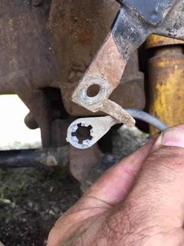

The battery relay assembly was out of stock a few months ago when I had a similar issue. I went to an old school auto parts store and he made me one from 2 separate assemblies. When installing the relay, I pulled off the passenger tire and inner liner. I found the ground points were bad where it attached to the frame and the starter as well.
On a separate note, there is a wire bundle running thru there. When the battery ends get replaced a few ties, the relay cable assembly gets shorter. This causes the wire bundle going to the trans and parts aft to ride on the exhaust manifold. Cleaned, replaced relay, threw in a new starter, repaired the wire bundle and have zero issues.
The burnt bundle explained why the PO had run jumpers back to the OD on the trans as well. Just throwing it out there for you to consider. Cleaning grounds and checking out your battery relay is cheap enough.
