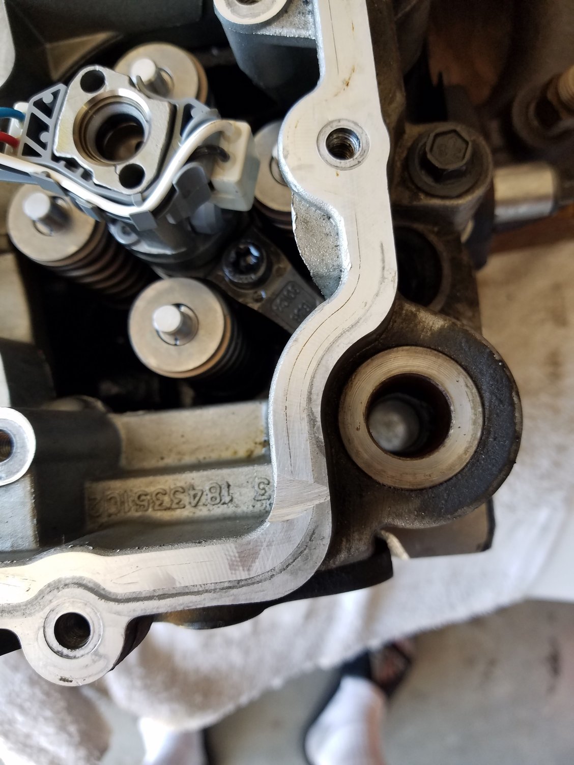

See the pic, but long story short I hit the corner of the rocker box with a grinder and put I small nick in it. My plan is just a little black RTV and hopefully the along with the new valve cover gasket should seal it. Also it will be located on the drivers front towards the bottom.

Unless you want to take it apart and get it welded, that's your option. Ideally, I would use Ford's silicone for diesels, but if it doesn't work it's just the cover needed to be removed.

Shouldn't be a problem. I've had good luck with Permatex Ultra Black...it is their most oil resistant sealant, used it for the HPOP cover.

I have had good luck repairing similar with 3M Scotchweld DP420 or JB weld. I scuff the damaged area,clean with Brakleen, apply the epoxy, allow to fully cure, then file & sand to original shape after curing. Good luck, Russ

Why did you have a grinder in there?

Well it was on the other side originally, and I was having difficulty removing the passenger side head. So I cut the head bolt off. Hence the oops.

I would never use a grinder anywhere under the hood, especially not with the valve covers off...
motorcraft grey sealant...

If I remember correctly the Ford sealant is made by Permatex, might even be the same as Ultra Grey which is lower viscosity than Ultra Black for tighter clearances...both OEM specified.

No, not the same. When I researched it it uses a different silicone formulation specifically designed for HPOP diesels that won’t leach silicon into the oil and potential foaming. It’s a Navistar/Ford item only, and a high price for that property. Grey, is not grey.
Now how much of an issue will a small amount of standard RTV cause ..... unknown.

I am going to use a little dab of ford grey, I'm going to the dealer tomorrow anyways to pick up a couple of little bits that have come in.

JB weld industrial epoxy. Let it sit over night! Use a file to dress it down. I watched someone use it on a block that burned between cylinders, due to a fixed timing distributor. The block held up for the rest of the race season. Approximately 8 weekends of racing.

Both of you guys are right, epoxies with good cleaning will work well. I'd use the 3M DP420.

Epoxy to fill the void.
Very interesting. I also realized I got the viscosity for Ultra Grey backwards...it is more viscous not less. I know cure times are important, seen a lot of people get impatient and not allow for the instruction specified cure time.

In some thread here when we talked about RTV’s I think I posted the different types in a chart.
i was going to use the Permatex versions due to the costs until I remembered the detail about the silicone from my 7.3 days.
This was after I used the anaerobic sealant often recommended for the lower gasket seals as a skin coat. That was a bad move when I decided to reopen the bottom end and discovered it doesn’t cure in the application.
