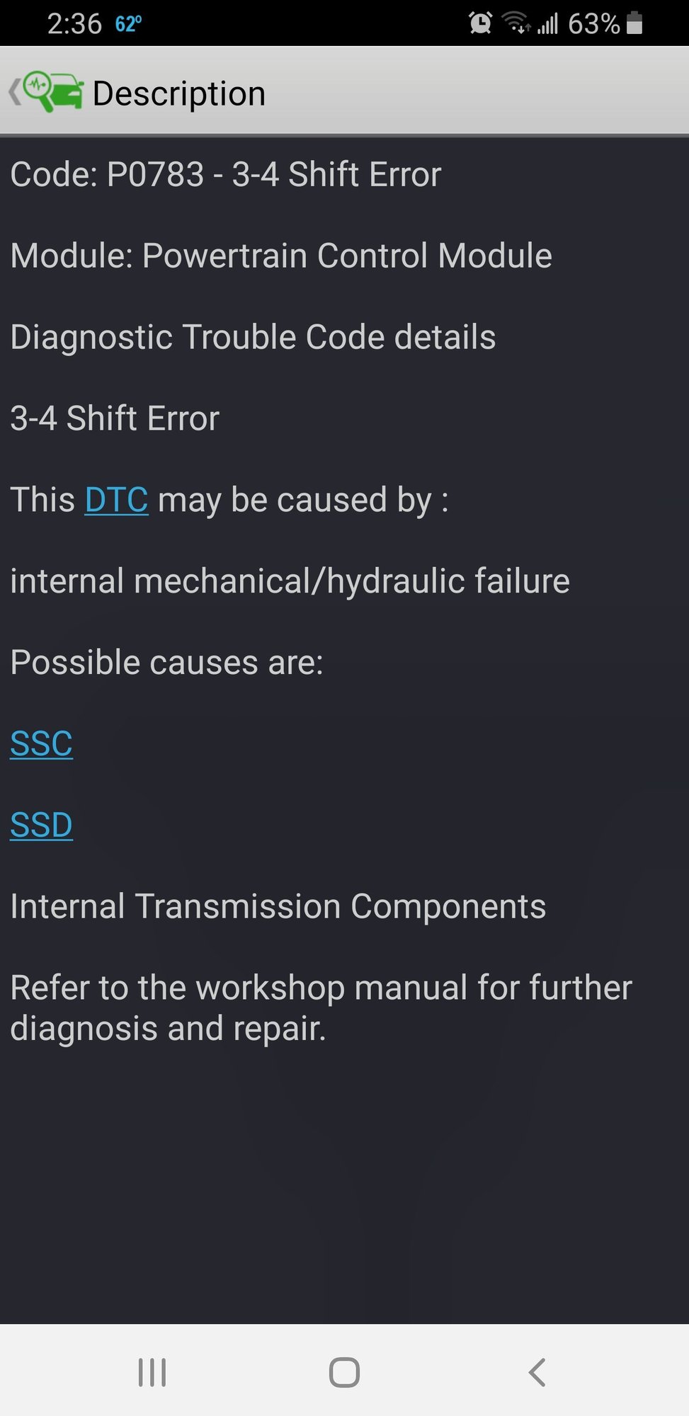

Code Pulled....P0783.....3-4 Shift Error
Well, title says it all.
Screenshot below:
FORscan Ex screen 10.5.19
Used FORscan. Neat tool.
Where do I go from here?

Next step is to get a factory workshop manual and follow the diagnostic routines.

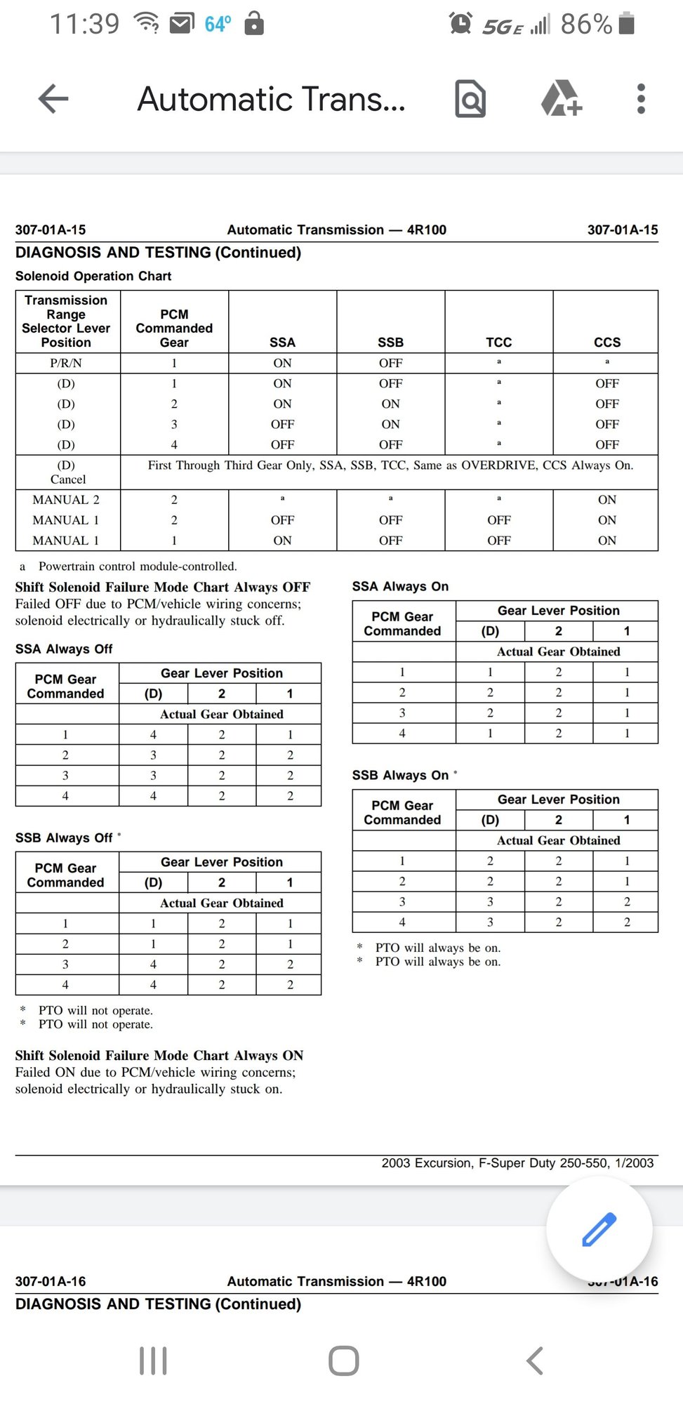

More Data
Seems my problem is not electric....or, at least, not with the PCM.
Factory info. shows 2 solenoids, working in combination, are responsible for all 4 forward speeds.
For 4th gear, both are off.
Since each are also "off" for other gear combinations, and the Ex otherwise shifts and drives fine, it seems weird that 4th won't work.
Factory Info.
I found scanning data for the 2 solenoids in FORscan and went for a ride.
Each solenoid went through its steps with no apparent faults showing.
Interestingly, the PCM thinks both are closed when speed gets to around 45. But, of course, 4th gear never gets to the rear wheels.
FORscan screengrab 4th gear
Even stranger, pushing in the OD button will turn on and off the 2d solenoid....with no change to the actually selected gear at the rear wheels.
So, the PCM is as happy as a clam.....but something is failing to occur between the PCM and the rear wheels.
I will check the mechanical/electrical connections to the tranny next.
Any ideas from the hive?
Is the mechanical movement of solenoid #2 different for 4th gear?
Thanks in advance.
