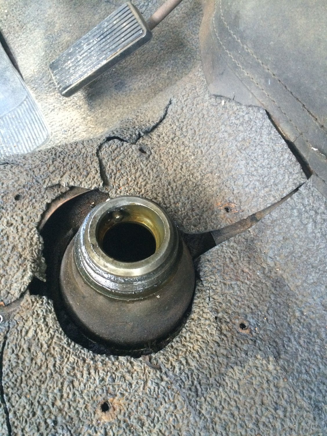

Any advice about this worn out shifter ? Can I buy a new one ?

Your "About Me" profile says: 1968 F250.
The shift lever retainer cap (8MTH-7220) of the Borg-Warner T-18 threads on/off.
C8TZ-7210-E .. T-18 Shift Lever / Obsolete
1968/72 F100/250 2WD & F350.
OBSOLETE RELIABLE PARTS in Nashville GA has 1 = 229-686-5101.
