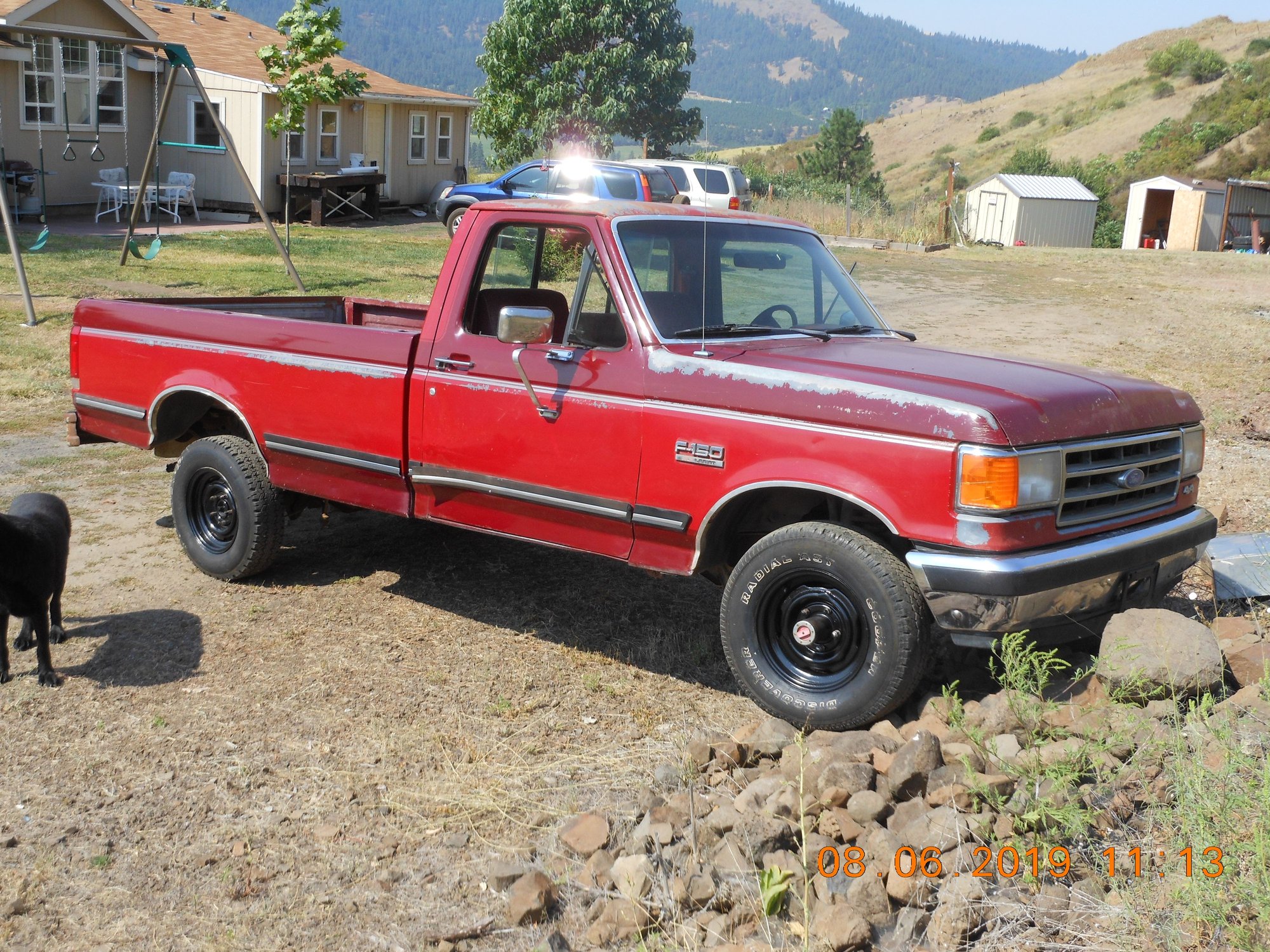

89 F150 w/5.0. Dual tanks. New fuel pressure regulator and in tank fuel pump in the tank i'm using. I hook up a pressure tester to the fuel rail, turn the switch on, the pressure goes up to about 35 then drops immediately all the way down to 0. If the pressure regulator on the fuel rail is working, it HAS to be a fuel injector problem right? This truck is driving me crazy Thanks all
