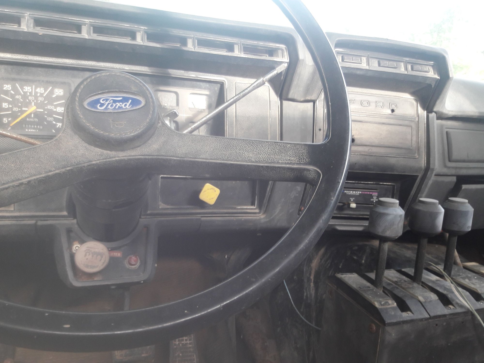

What is this?
**** below column. Has a red cable which goes through firewall then back under floorboard...not to engine compartment.

PTO cable?

I'm guessing the same...

Is it hanging in mid air or connected to something?

The **** is firmly connected but doesn't pull or push. Keep in mind..there is no power yet. The cable is loosely threaded through firewall then back but not attached to anything visible. I'm guessing PTO.

OK, you have a dump truck. Is there a hoist under there, or did someone liberate it before it was parked?

This truck was owner by the county...used as a salt truck. Spreader in back, belly blade, front blade. It still has all hydraulics and operator controls for each. I don't see anything resembling a hoist or where one would even mount.

It's a old cable type idle lock, should be able to twist and pull to adjust and lock idle RPM. Useful for PTO if equipped.

By hoist I mean is there a hydraulic lift to dump the bed?

Throttle adjustment or a way to control the gate on the sander.

85e150...I haven't had the chance to figure out which is which but there are multiple handles in center console. I believed one is for the hydraulic dump bed.
