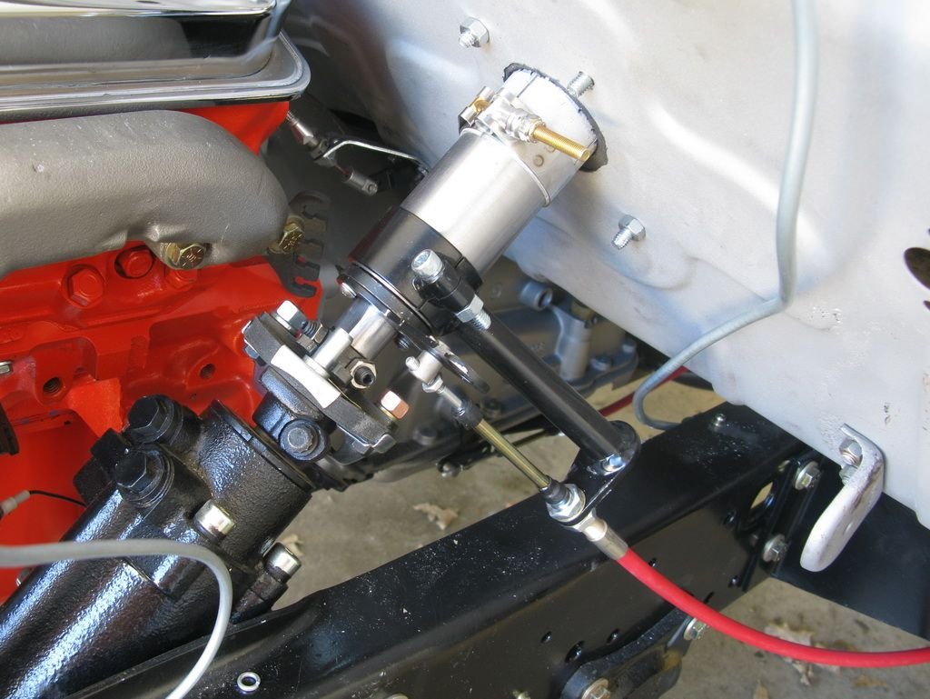

I have a cable kit from IDIDIT on my '68 Torino that is a column select C4. I added longtube headers that didn't clear the factory mechanical linkage. Essentially the kit is a cable that attaches to the original 'ear' on the automatic column that rotates when you move the shifter on the column. The cable attaches to this 'ear' and is then anchored so that rotating this 'ear' pushes and pulls the cable which is attached to the transmission gear selector on the case.
If you had a steering column for manual shifting, I'm not sure how this work work. as the cable requires rotational motion to push and pull it and I'm not familiar with the operation of the manual column shifter mechanism.
I have attached some pictures so that you can get an idea of how it works. Hopefully this was helpful.

In my case, it was not necessary whatsoever to remove the steering column. The guide clamps around the column as depicted in the pictures, so I can't figure why the instructions would say to remove it.
It was (and still is) a real pain on the Torino with how little column is exposed from the firewall and how little room there is with the fender being so close. I imagine it'll be quite a bit easier in the truck engine bay.
