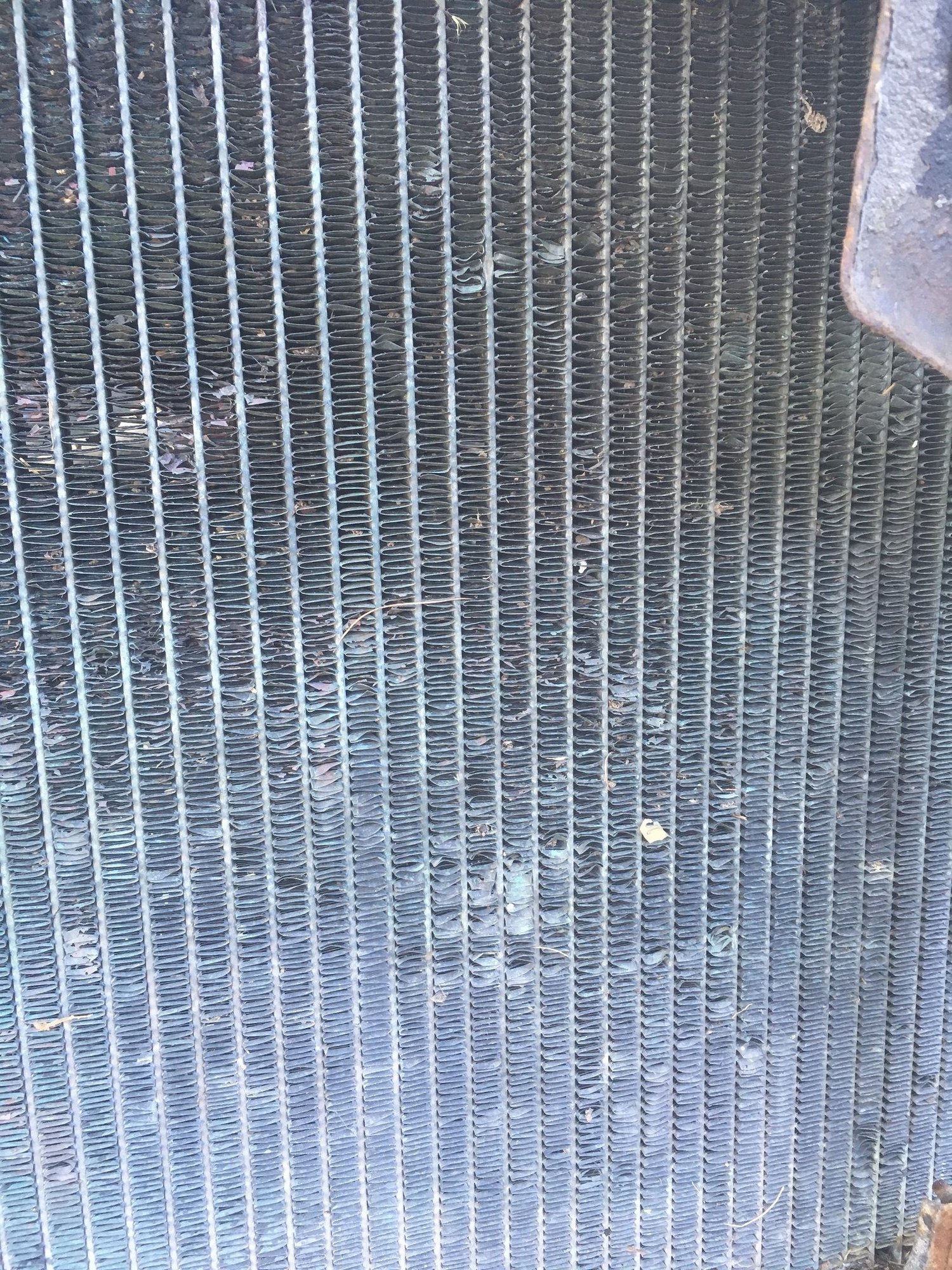

I had a garage look at it and they're telling me that I need a new radiator. This is the first time I've run it for longer than a few minutes and I'm not really sure what condition it's in. It doesn't leak at all and might just need a flush - I'm not sure if I'm getting taken for a ride or not. Here are the fins. Any feedback is appreciated.
Old Oct 4, 2019 | 03:38 PM
Tedster9's Avatar
Tedster9
Joined: Apr 2002
Posts: 19,311
Likes: 97
From: Waterloo, Iowa
Very well could be, I brought a rad in I thought just need the neck soldered up, and the guy explained how it had been leaking for years. The corners. They don't necessarily lose enough coolant to notice, but they won't hold pressure too well. They can be repaired sometimes, not always. Labor is expensive, and they can't guarantee success because it's 50 years old... you know the drill.

The fins is just 1 thing to look at.
Is there any green tint on the out side anywhere? If so it is leaking around that area and will not get any better.
The real place to look is inside the radiator. Can you see the tubes when you look in it?
Do they have any white crusty build up around them?
If so then the tubes could be plugged with that stuff and a flush will not remove it.
You can also get the truck up to temp, shut if off and feel across both sides of the face of the radiator.
You should feel the same temp across the whole face if not it is plugged.
Most of the radiator flush you can buy in stores will not do anything so save your money.
I used vinegar, its an acid, to eat at the crusty stuff. I removed it, did a quick flush with water & drained, capped it, laid it flat with the hose ends sticking up and filled it up and let is sit about a week.
I dumped it and flushed with water and repeted with fresh vinegar for a week again.
It did remove a lot of the white crusty stuff as you can see it when you drain it but that white crusty stuff was also holding it together.
As soon as I installed it and filled with water it leaked so I got a new one thru Rock Auto.
So as you can see you can do a quick check by feeling across the face if plugged but short of rodding (shop would remove a tank and run rods thru each tube to open them up again and hope they did not poke a hole thru them) or re-coring (shop removes the 2 tanks and installs them on a new tube & fin "core") there is no real fix.
BTW the old radiator was copper / brass the new is plastic / copper and is cooling just fine.

Looks like it was the radiator! New one is working well. Thanks for the assist.
Old Oct 14, 2019 | 02:14 PM
AbandonedBronco's Avatar
AbandonedBronco
Joined: Dec 2007
Posts: 7,987
Likes: 104
From: Boise, Idaho
Awesome! Old one must've just been plugged up beyond fixing with a flush.
Glad you're keeping it cool and off and running. Thanks for the update.
