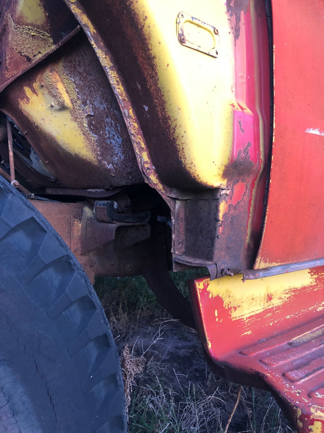

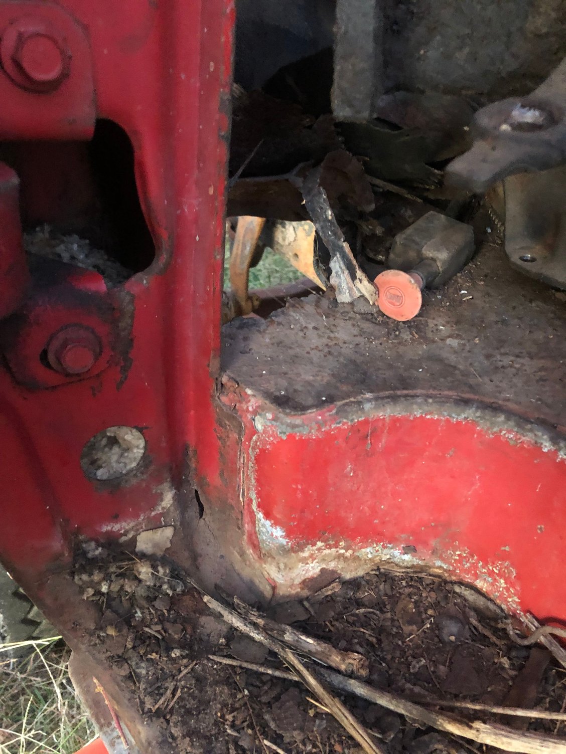

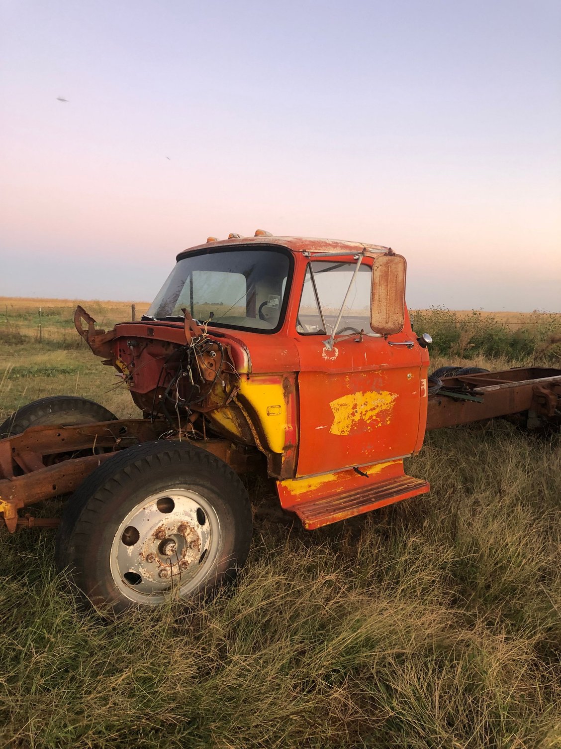

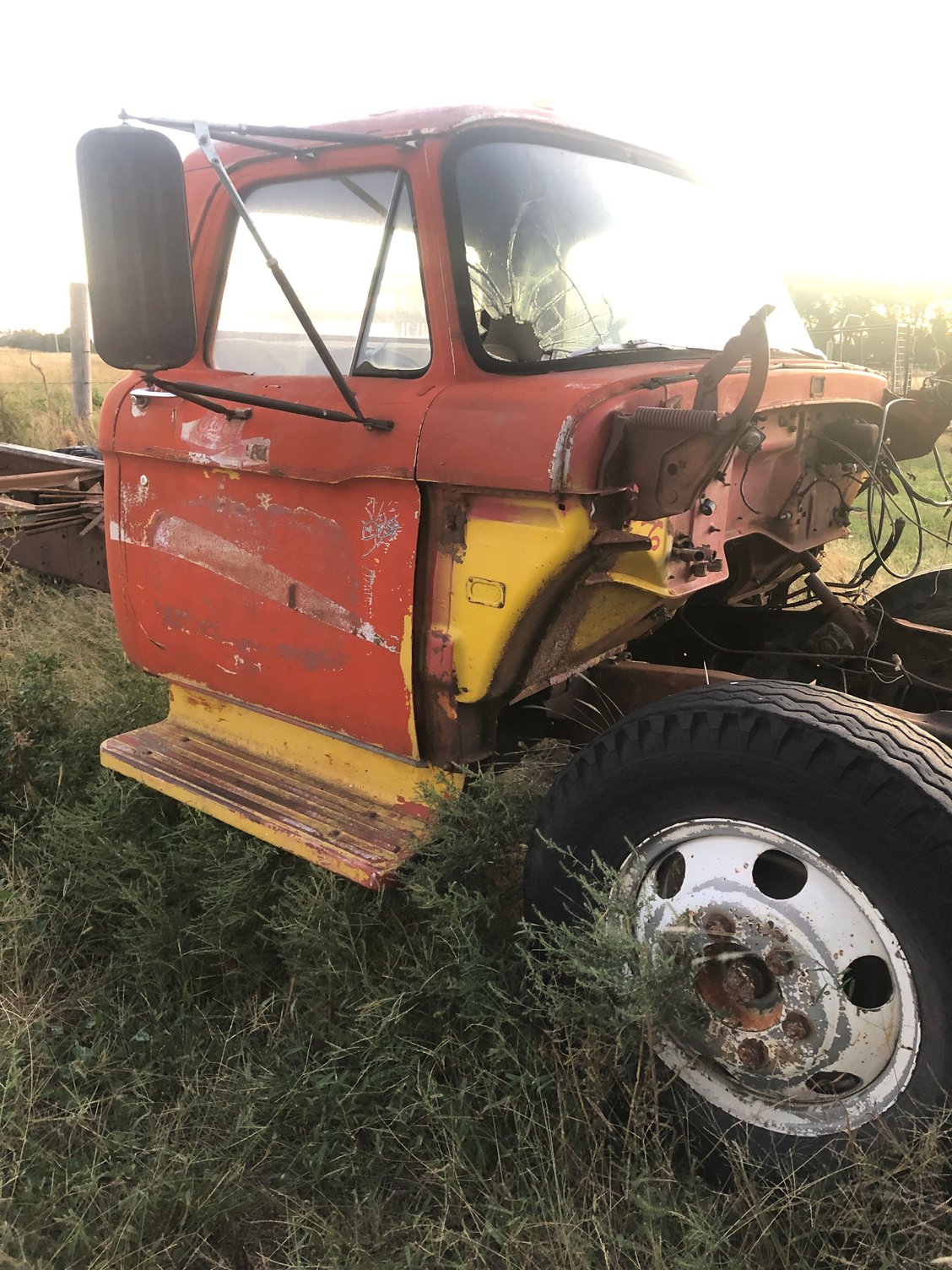

I’m wondering if the cab off of this grain truck will be a direct bolt to a 1966 f100 frame will that bolt on and is it possible to do thanks

With the step up inside the door, no I don't think they are interchangeable. The 65/ 66 had a different cab mount when they switched to the twin I-beam and the cabs did not have the step. Plus, this one looks like it is not too far behind your other cab. Just from the pictures posted, you can see the driver side floor pan and lower door pillar need repair and judging by the rust from the exterior picture on the passenger side, I would almost bet on the door pillar on that side as well.

i was wondering that I know the 65 and 66 cabs are different didn’t know if it would work or not

Cab step, visible when the doors are opened: 1961/64 all, 1965 F100/250 4WD & F350/1100, 1966 F250 4WD & F350/1100.
No cab step: 1965/66 F100/250 2WD, 1966 F100 4WD

The simple answer is definitely not a direct bolt onto a 66 2whl dr. Not only are the mount different but so is how the steering column mounts which affects its ability to even line up with your steering box. Brake master or booster will need mods to bolt on as well. The 61-64 truck really is a different beast that just looks the same.
