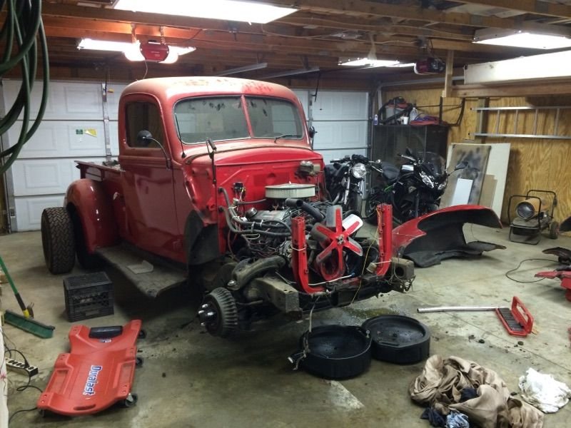

Once I blew out a tire and the engine felt tired, I decided to pull it in to the garage to pull and rebuild the 302. Naturally, we took off the fenders for easy access. Which then led to the rear fenders, running boards, etc. Every bolt was rusted and either had to be cut, or would snap on the final turn. I had build a nice wood frame that I could attach to a cherry picker to lift off the cab. good stuff.

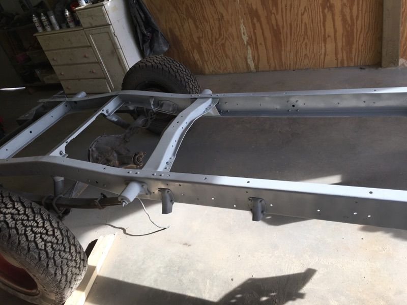

Once I got it down to the frame, I had to paint it right?? So after a trip to harbor freight and home depot, I created a plastic room and started up the sand blaster!

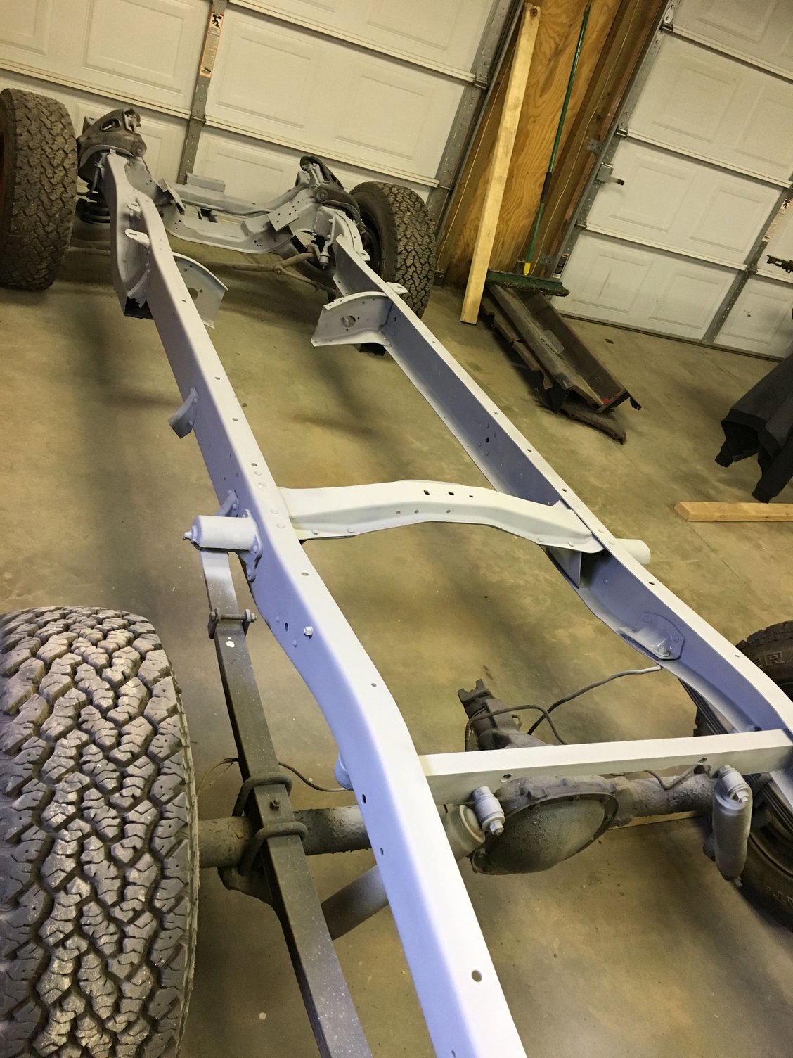

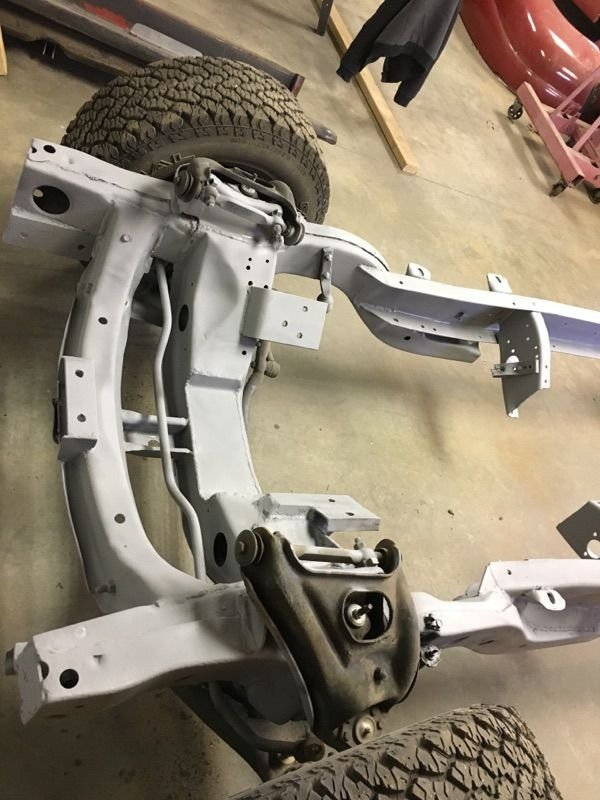

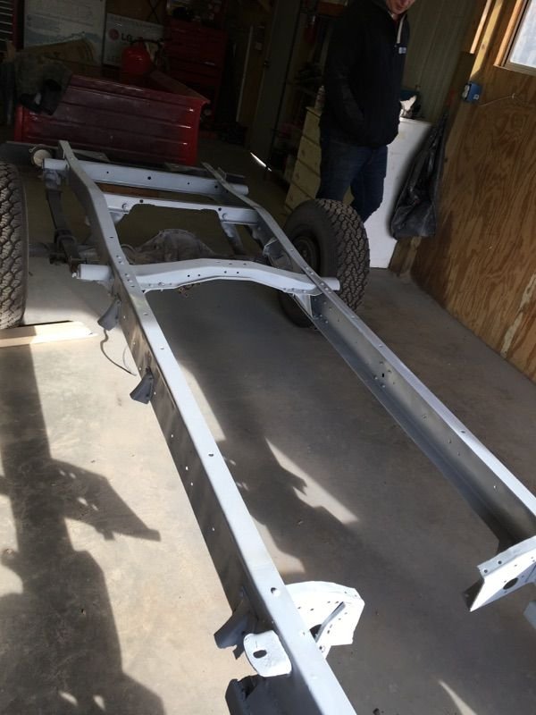

And now to today. I have finished sandblasting and laid on 2 coats of primer. My next step will be a nice gloss black top coat.

And moving forward. The truck is in my brother-in-law's garage as I love in an apartment. He bought a house last week so in the next day or so we will be transporting everything to his new garage. From there, everything will be new.

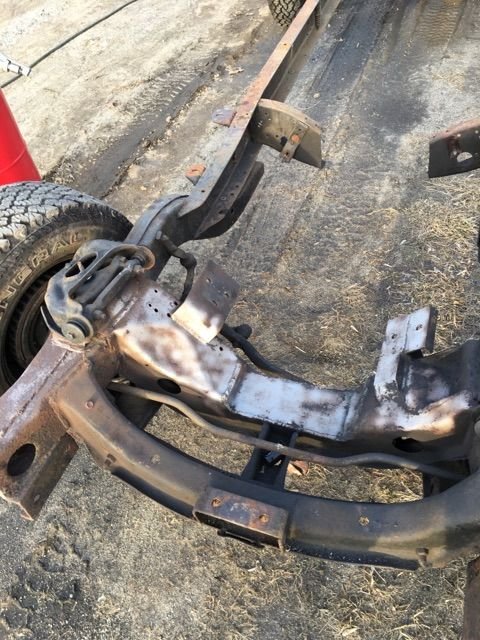

What is that front frame clip/suspension? Kinda looks GM, but that crossmember looks odd...
How well will the 460 fit in there? those engines are huge!

You beat me to it. I was going to ask the same question about the front suspension. Your pickup has a great body! It is good to see that you are making good progress on the rebuild. What kind of a steering system do you have? It seems unusual that the original steering sector mount is still intact.

I THOUGHT it was a mustang II front end, so I was pretty excited. Unfortunately, it's a 67-69' Camaro. I have nothing against them as I used to own one in high school. I just thought it would be cool to have all Ford.
Yeah, the 460 will suck lol. Instead of fabbing up some motor mounts, I'll be running both a front and mid motor plate. I'll be cutting off those weird mounting plates since they're just welded on there. The idea was to put something in there that I won't get sick of, and if I do, it has unlimited potential.
It had a steering box from god only knows. It was leaky and old so I tore it out. My best bet will probably end up with a rack and pinion. But that will come after I have the motor in and mocked up.

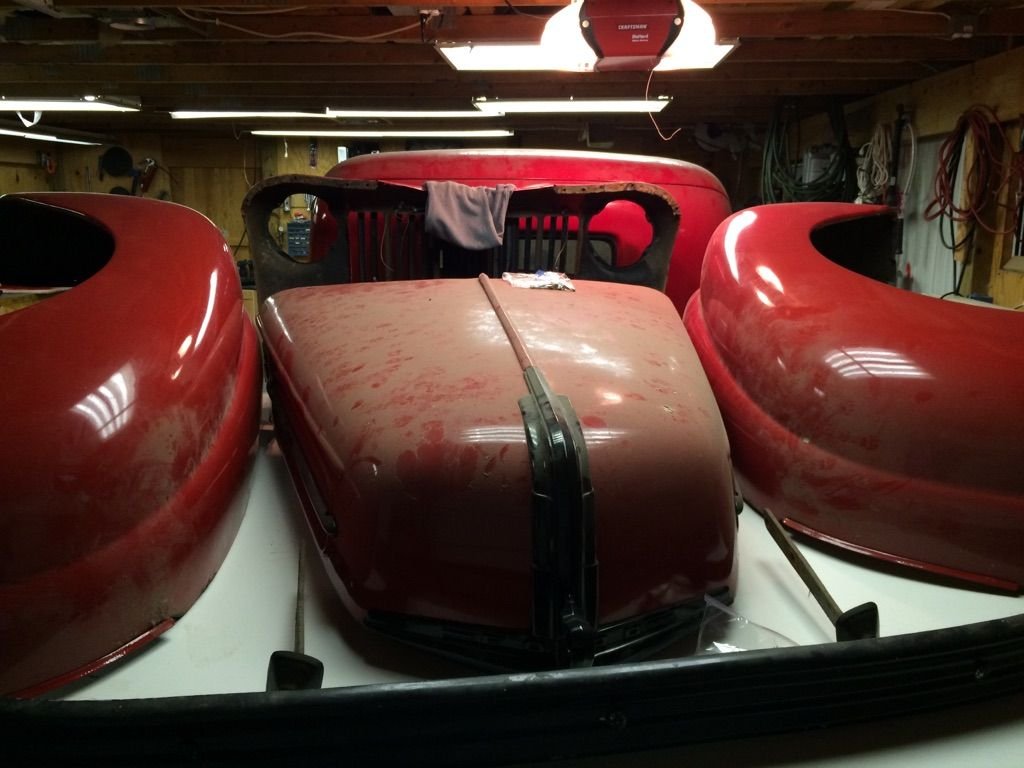

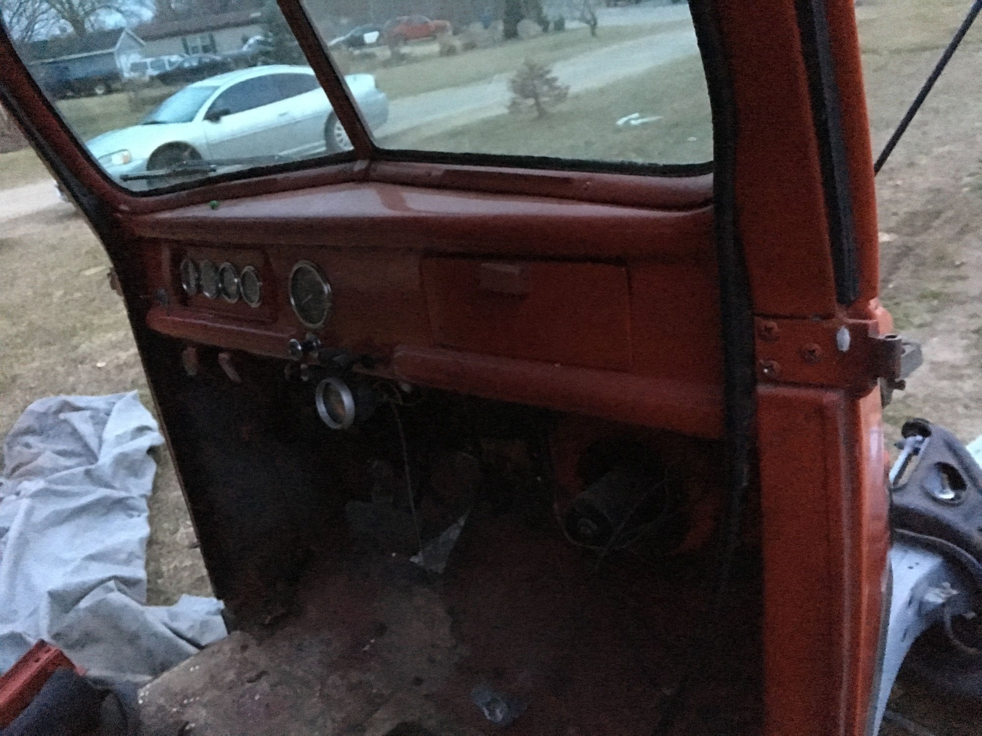

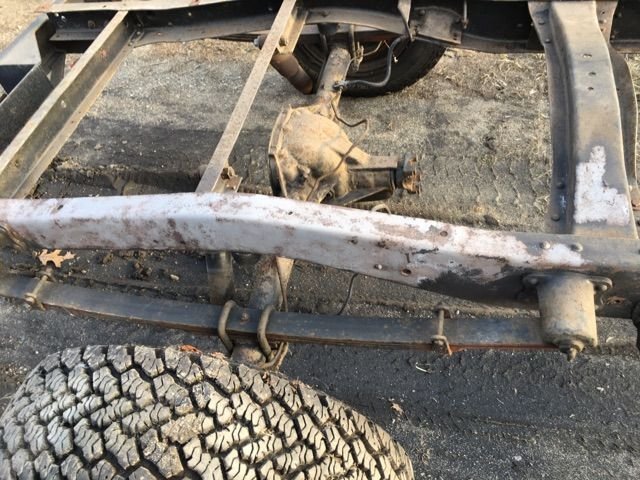

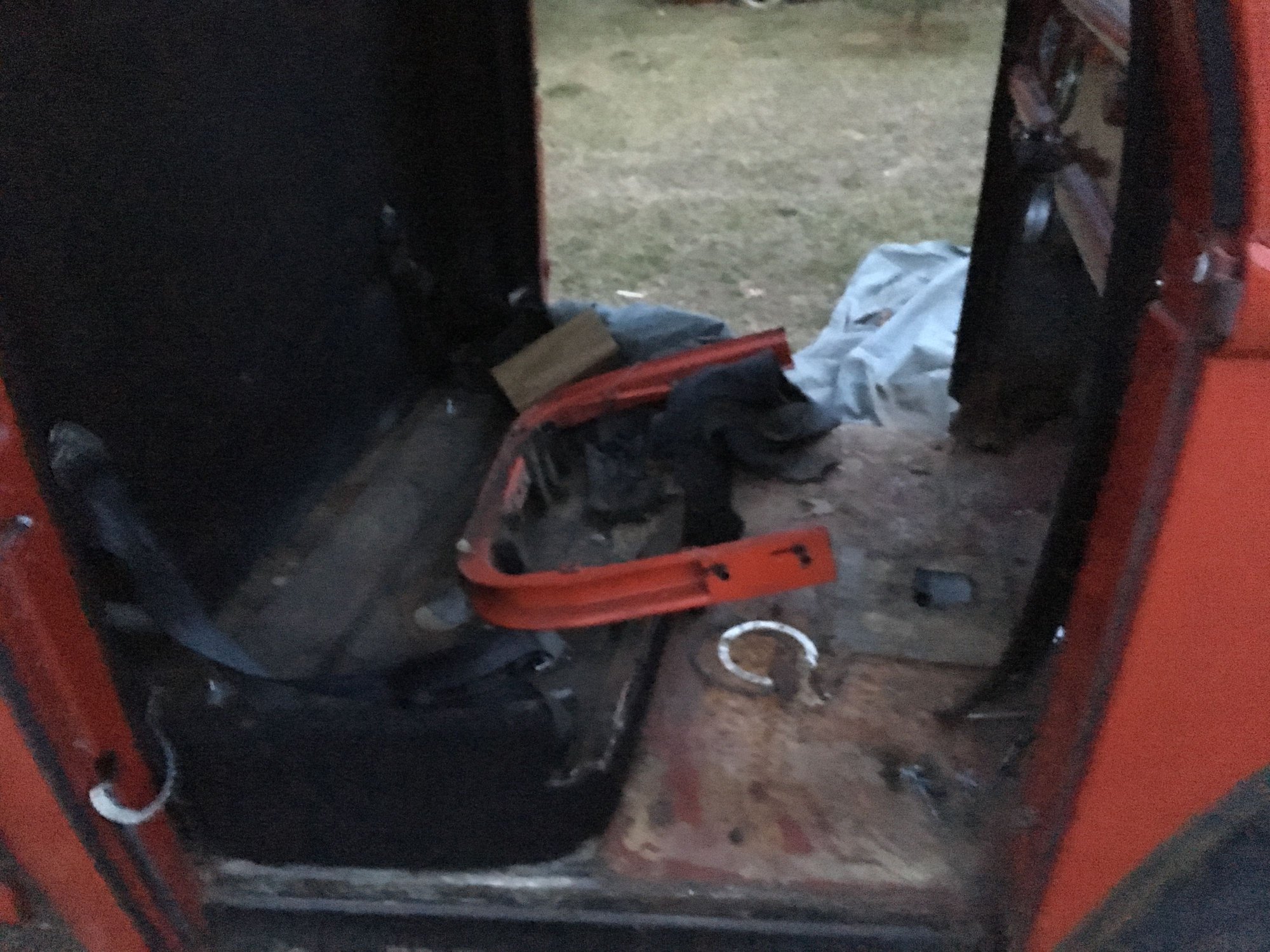

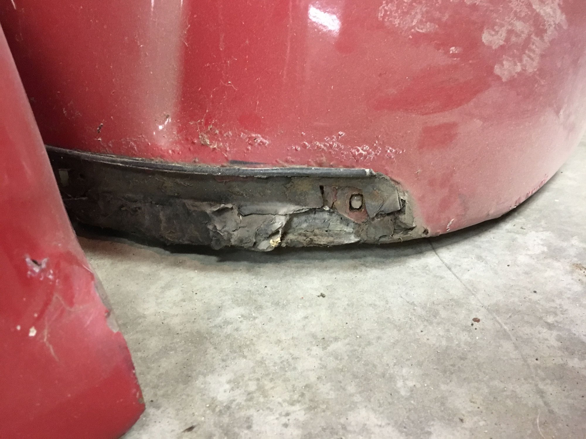

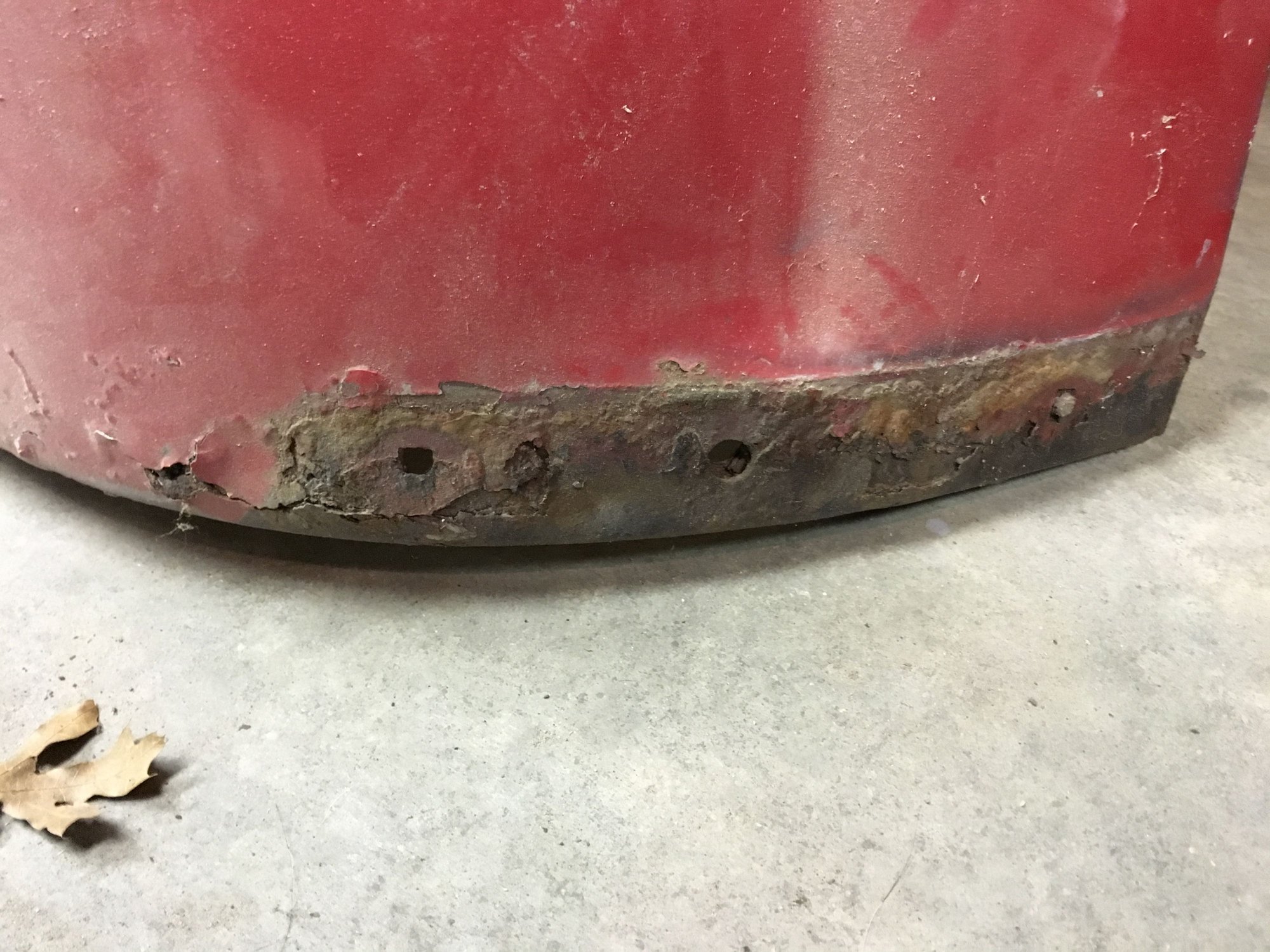

Here are some pics of the body. I'm replacing the majority of the floor, grinding the old gas tank section flat. The new tank will be in the bed. Here's a couple connecting points of the fenders.

Hey can anyone please give me some insight around my frame. I'm going to drop in a mild 460 (maybe 400hp) and am unsure if I should box my frame in. I know they are built to flex, but I'm unsure on how much they can take. Thanks for any advice!
