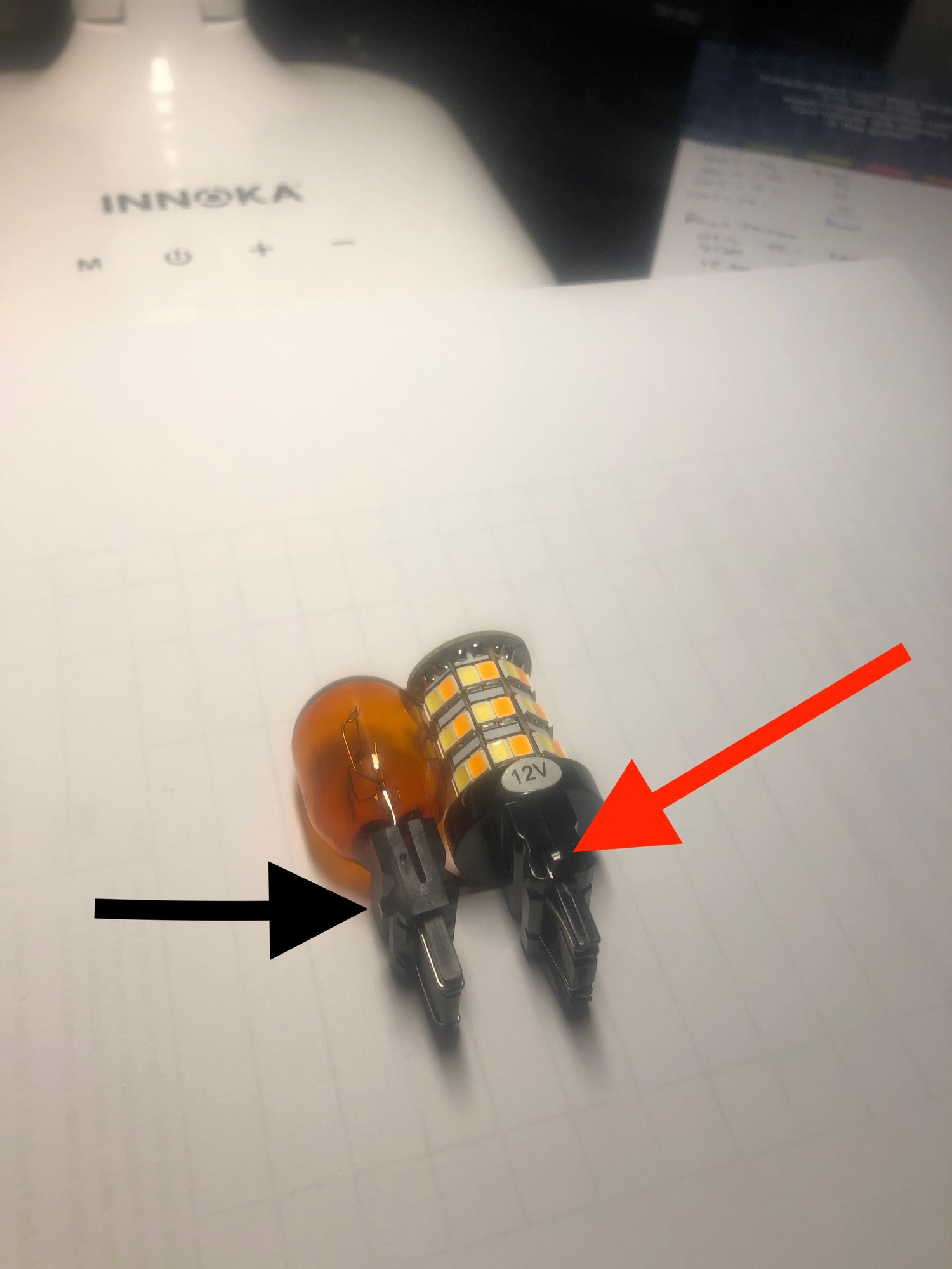

Photos aren't fantastic, but hopefully they make the point. The base on the stock 4257NA is the tiniest bit narrower than the 3157 LED sent by Superbright.
Also, the nubs (apparently also known as "locking tabs") for the stock bulbs are on the on the wider side of the base. The replacements have the nub on the narrow side.
Could I have ground them to make them fit? Probably. In fact I did grind the nubs off of one replacement but did not attempt to narrow the base on it. But I'm guessing that I'd be no further ahead than I am with the current Alla bulbs that I ground the bases on as far as fitting securely. After spending an hour fishing 2 bulbs out of the headlight housing, I guess I'll just live with the current setup. It looks good and works as it should. The only reason I messed with it was to try and get a bulb that would snap in and fit securely as the factory bulbs. Surely I can't be the only person with this complaint.

I may be onto a good solution finally. Headlight Revolution sells a kit for $88 with resistors. Further research shows that the bulbs sold by HR are made by GTR and are 4257 compatible. The bulbs alone can be purchased from GTR for $59. I'm just waiting for confirmation from them on fitment. I've made FORScan adjustments so have no need for resistors.

I can confirm that these lights from GTR, DON'T fit in 2017 F 250 front sockets.
I'm in process of returning to GTR now. Waiting to here from them ???

I can confirm that those GTR 4257's are indeed in and functioning in my 2019. Could Ford have made some change to the sockets between those model years? Nothing surprises me anymore.
And looking back on my previous post, I guess I never did report back on the fit. Sorry! But again, they've been installed and working in my truck since September 2019.
The bulbs I installed are pictured. No idea if the number is an actual part number, lot number or what or if it's subject to be changed. A search of that number turned up nothing for me.

Thats what Im thinking, They Must of change sockets, Here is the Factory Part# for stock Incandescent bulb,
OEM Ford Blub And it's not a 7444na or 3157na. Base of Bulb Has something different than over the counter Bulbs you buy at parts stores.
Ford Part# DR3Z-13466-A

I went down the road you're on with my 2017. Many of the Amazon bulbs as well as places like Superbright LED were trying to say that their 3157 or 7444 bulbs were the solution. As you know, they certainly were not. The nub or "locking tab" wasn't in exactly the right spot and the base on these replacements were just a shade wider than the stock bulb base.
Myself and a few others took a Dremel type tool to the base and made them work, but to me it was not ideal and they could have been more secure.
I was pretty happy when those 4257 GTR bulbs snapped right in on my 2019. Seems strange that Ford would change the socket for something as pedestrian as a front turn signal, but these things happen all the time. Maybe they found a lower cost vendor for them.
