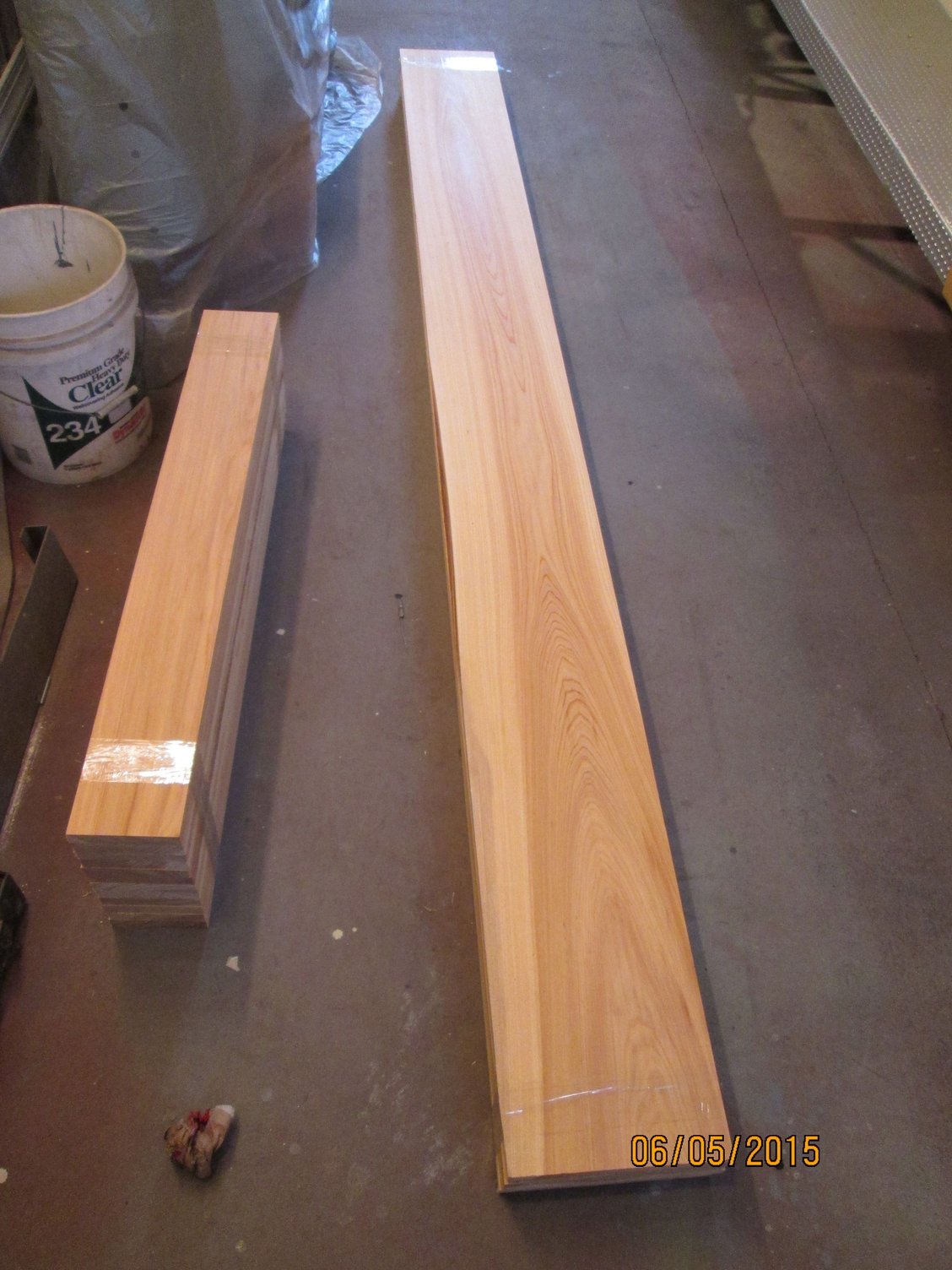

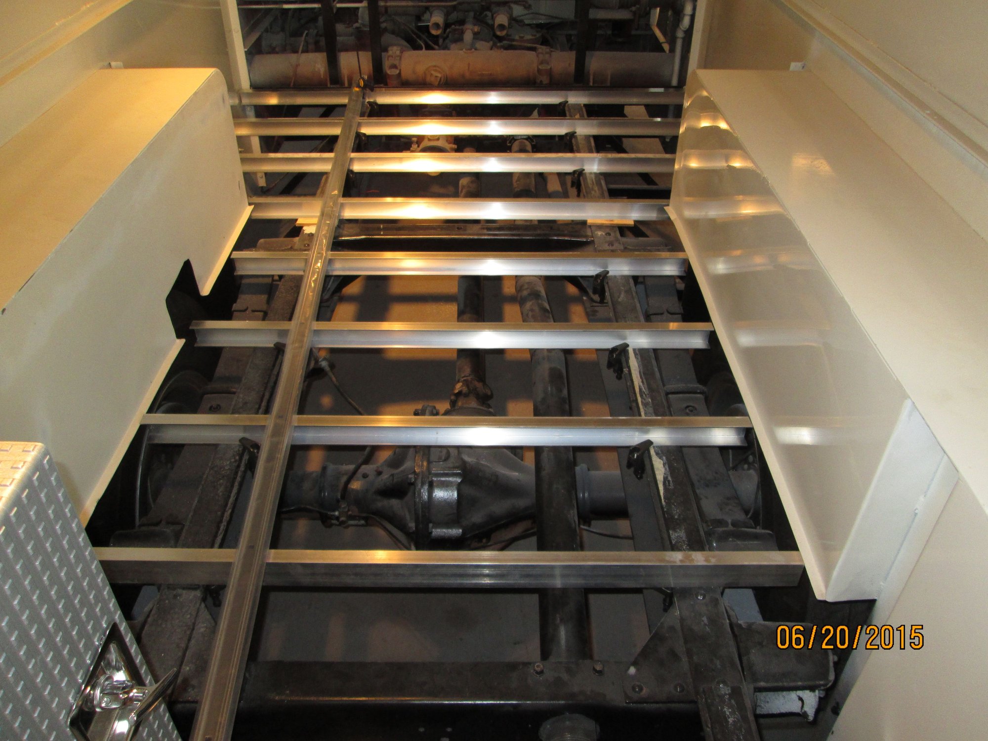

Don, When I did my bed, I had a custom installation. "54 F750 fire truck. I used Mar-k Mar-K Manufacturing. this place was awesome. they can custom length, custom punch holes. Great to work with. I had cypress milled to the width I wanted and groved for the strips.I will post some pictures. Good luck in your search. I used polished SS

Looks great, I like the cypress. have used cypress to build out door chairs and it holdup pretty well outside. I have that same Delta Unisaw.

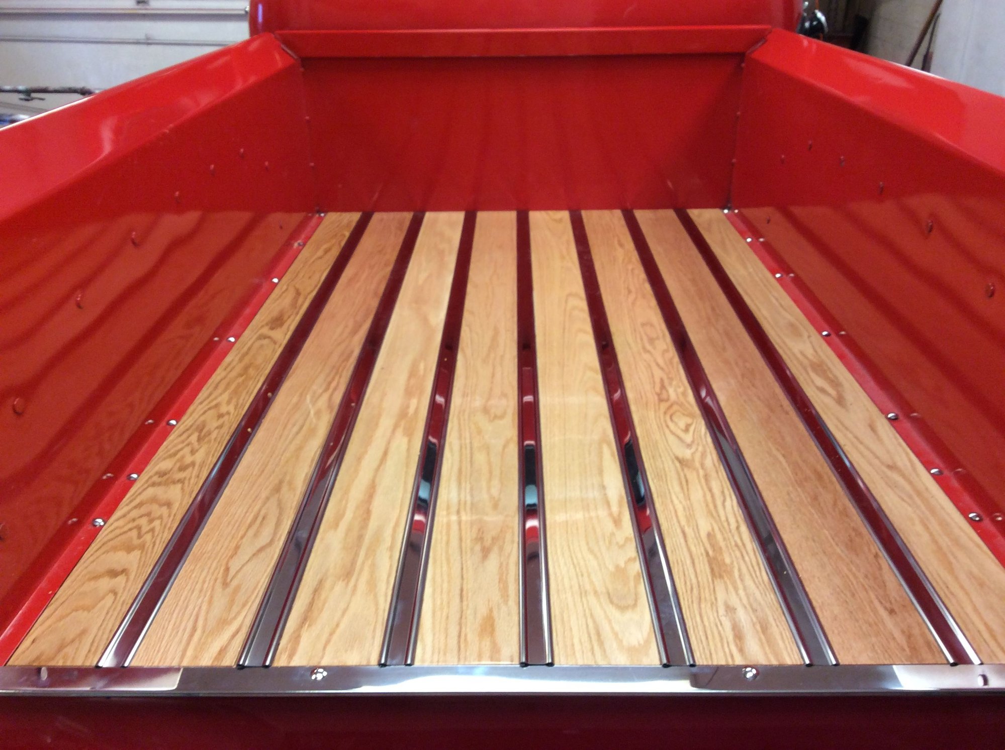

Since I'm a make use of what you have guy, I used old barn wood off a barn that was destroyed when a big tree decided to flatten it. My divider strips are also barn wood stained a different color for contrast.
Most of the wood on the barn was white oak. After it was planed, it wasn't perfect, but as my wife said, it had character.
Divider strips were cut to allow movement of the main boards.
My wife stained the divider strips.

I like the wood slats, I was thinking about that and made a mess of my shop making a prototype. Looks good. What are you all using for finish Poly?

Wow...while looking for something else I actually came across the photo of the bed with the stainless rods in the bed floor. Wood looks pretty nice too!
