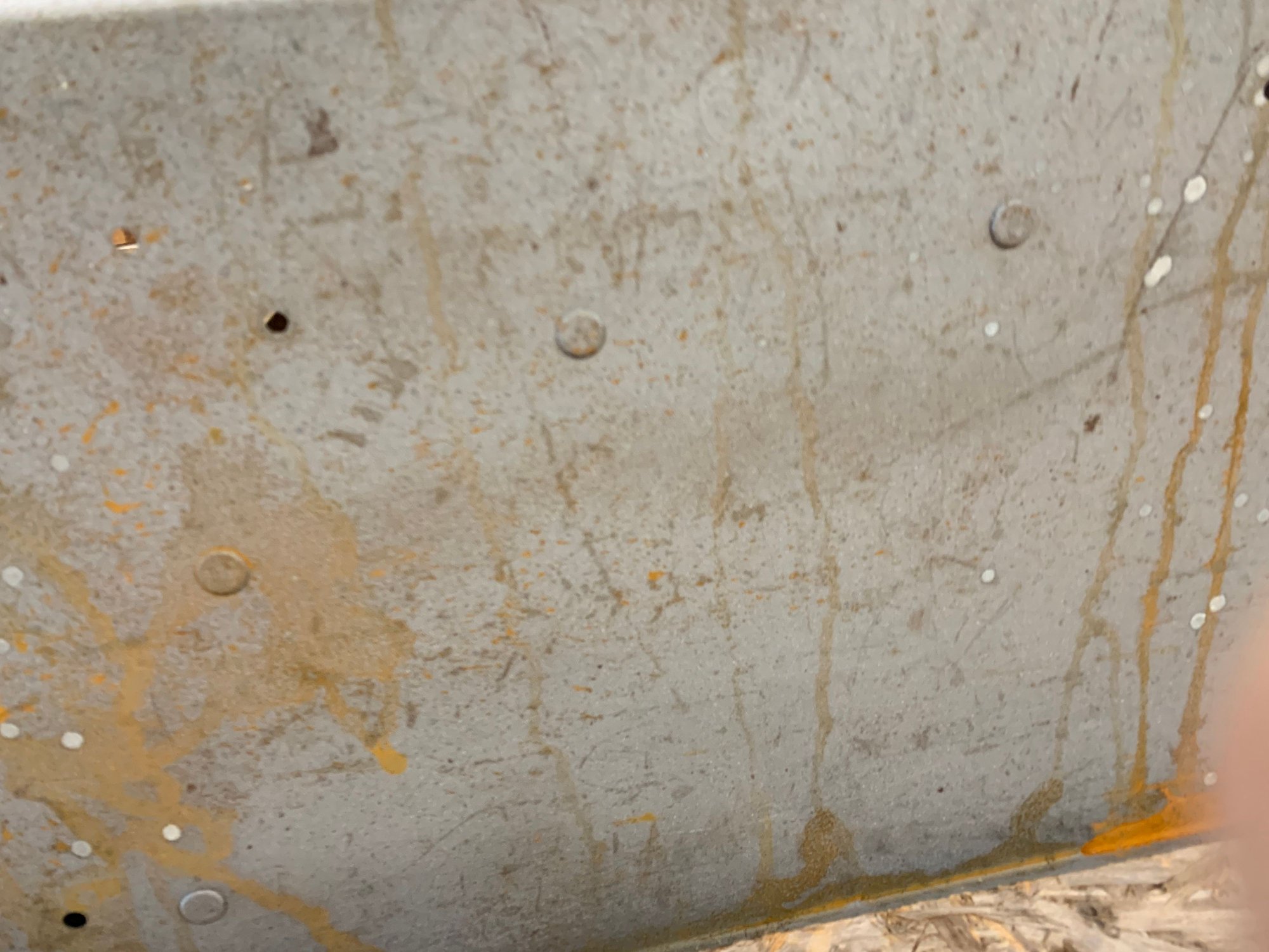

Any one have a recommendation on how to remove the fender bolts without damaging the truck bed sides?
it appears they are either welded or ribbed bolts.

Fenders are already removed? The bolts should be splined shank and pop right out with a whack with a deadblow hammer.

Mine had 3 small spot welds holding each flat head to bedside. I used an angle grinder and cut off wheel. I cut the flat side in a cross pattern from inside the bedside then split the quarters off using a hammer and chisel. You'll never knock them out with a solid blow if they are tack welded. Mines an 8' bed so not sure if they are held in differently than a 6 1/2'.
