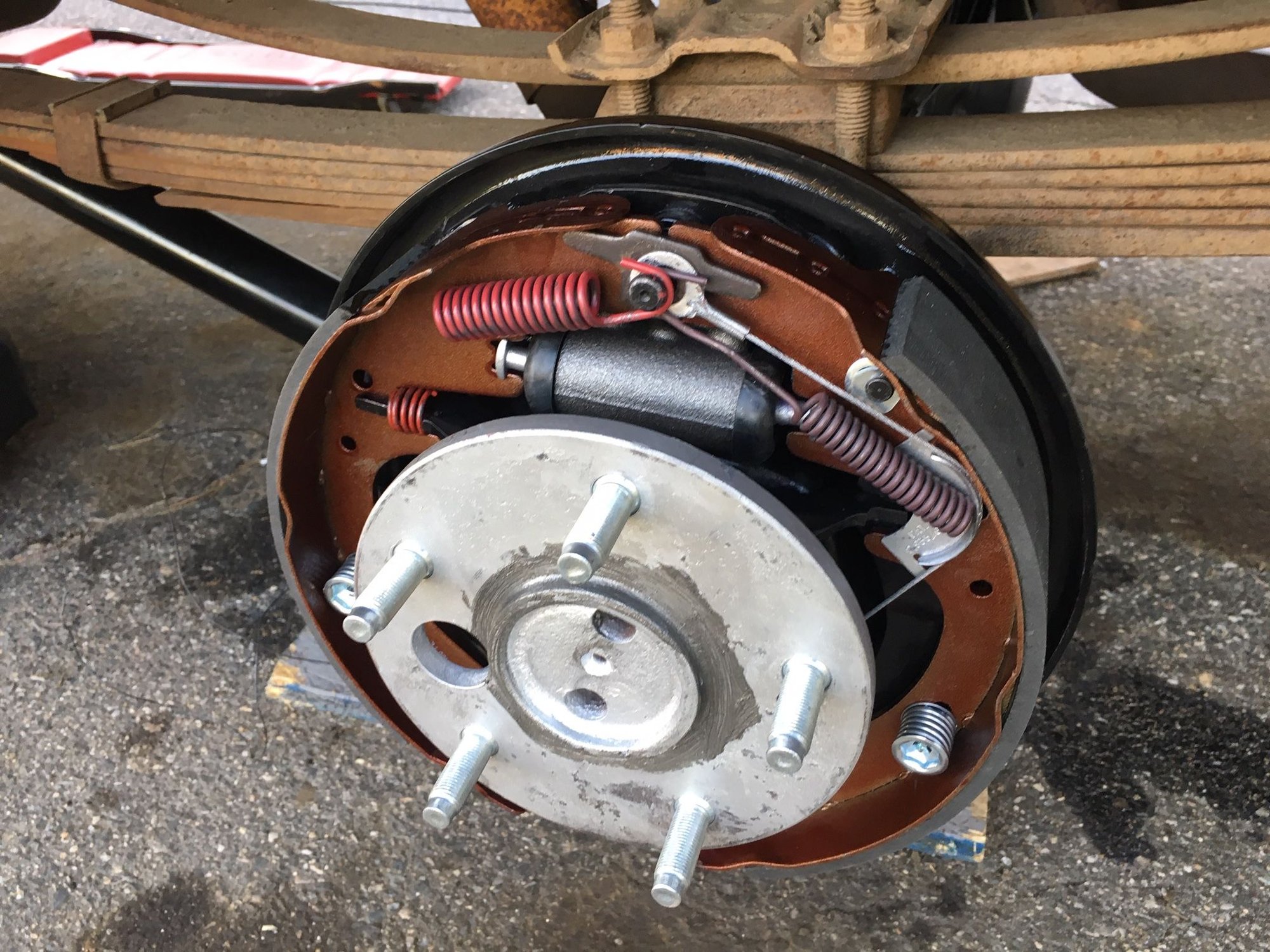

Here are some related progress pics. Rear end teardown, every bit of rust and grease and nastiness removed, every part and piece stripped to bare metal and repainted. Lots of midwest dirt and grime to chisel off, but thank goodness it protected the metal underneath. One piece at a time..

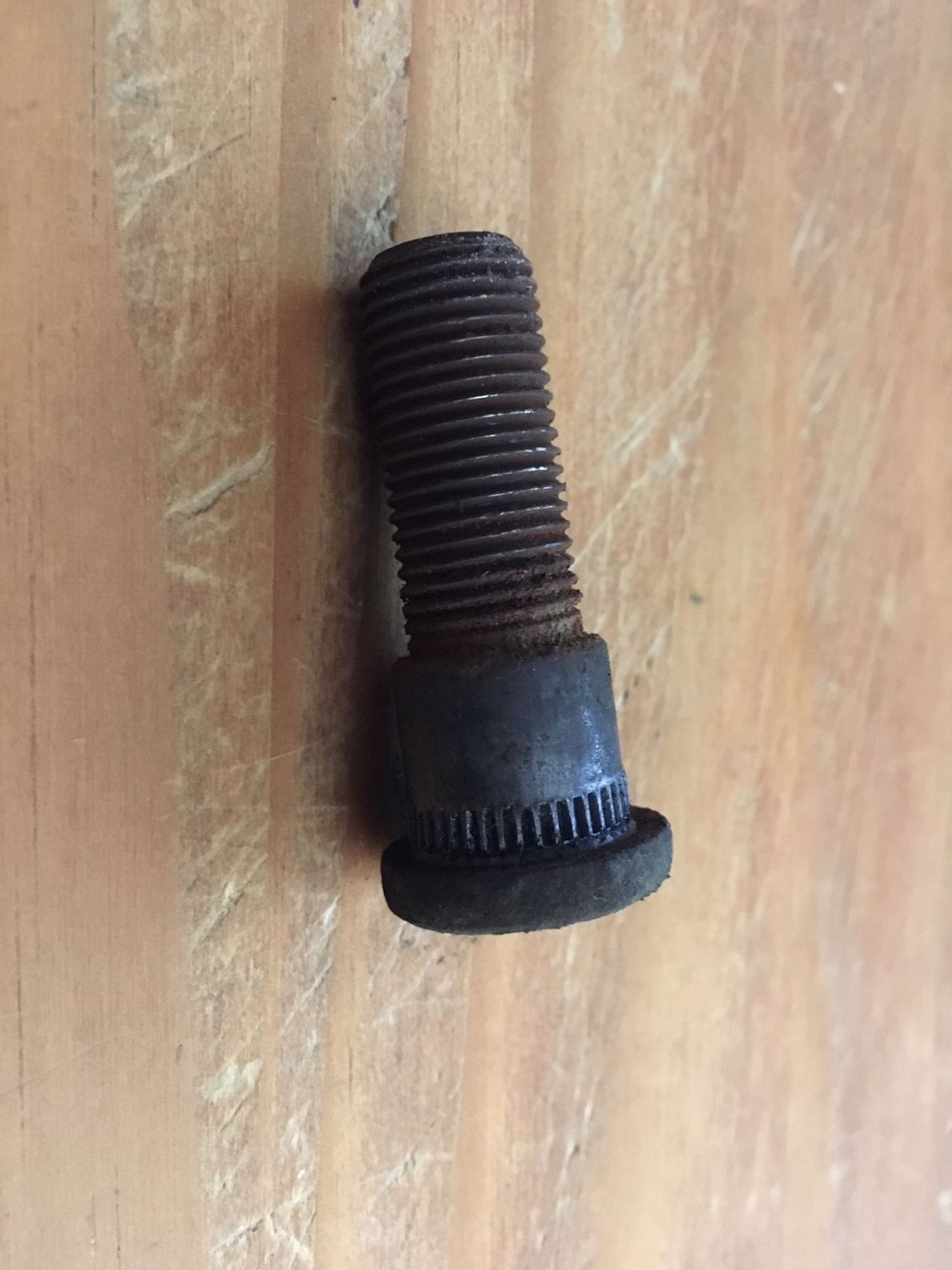

Found what changed - It was the lug studs. New ones did not have a shoulder on them like the old ones. Picture below for reference. That shoulder brought the diameter to around .610.... explains some things
