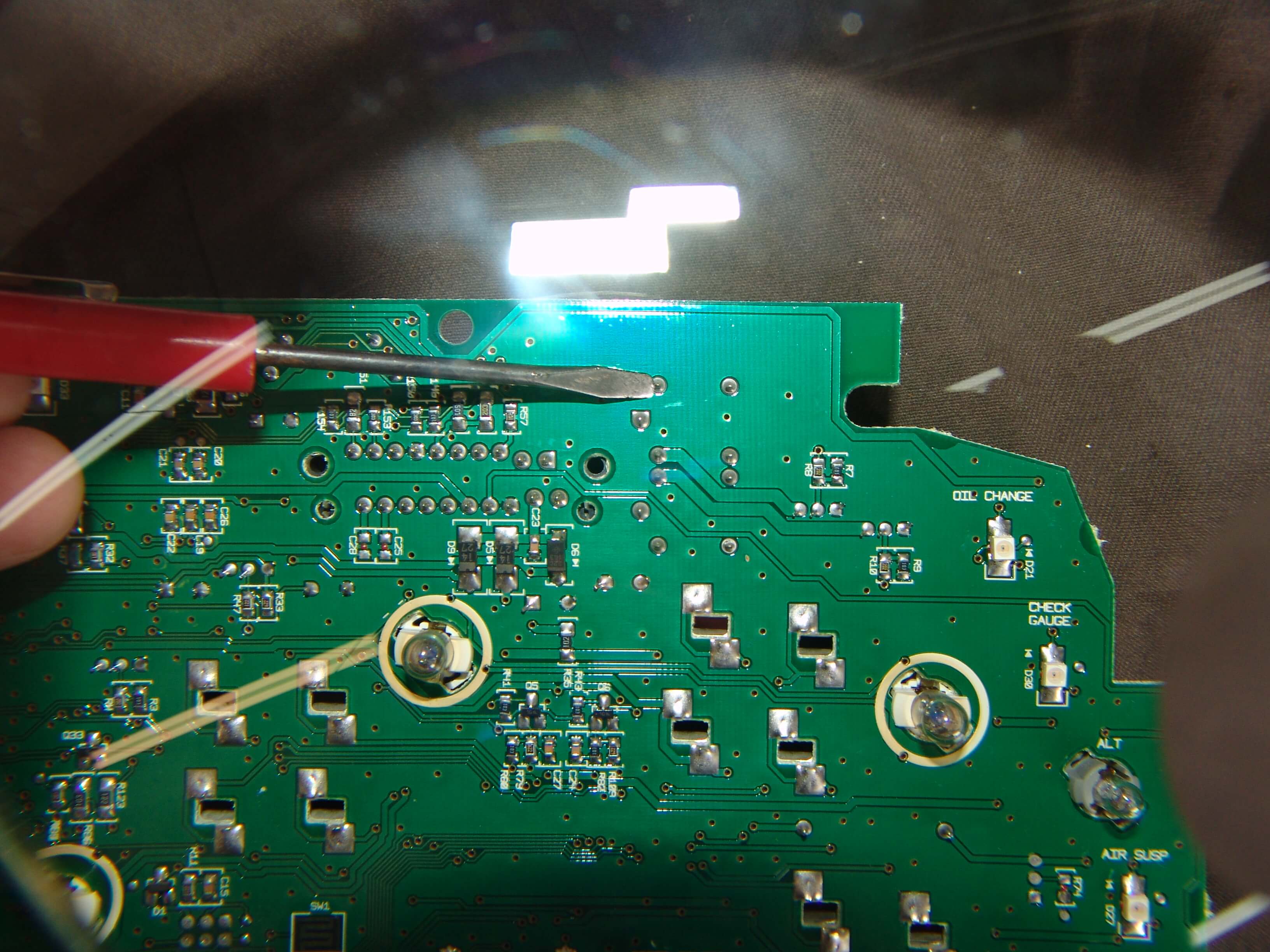

It looks like it's the dreaded battery saver relay is the cause of the issue then. Apparently it's something that would need to be sent out. I've also read that all it it needs is a reflowing of the solder at the joints. I've done that on Mercedes cruse controls an climate control boards before. I've even reflowed the solder on a MAcbook mother board so I feel I could fix this problem myself. I've tried to find photos of the board showing the relay but no luck. I've only found wiring diagrams for it. Does anyone have a link to a photo of it? I don't want to spend a ridiculous amount of money for something I can do myself.

I think I found a decent write up of what needs to be done. The hardest part looks like the tear down process.
https://sparkys-answers.com/2016/08/...p-working.html

I got around to pulling the dash apart to get to the cluster today. I lost power to the radio and windows again and I just got frustrated with it. No amount of banging on the dash as suggested elsewhere made any difference.
The hardest part was pulling the radio out. I've pulled Ford radios with the U-shaped tools many times before but this thing would not budge. I ended up trying to pull it with the dash bezel. That didn't go too well. I don't know what happened but the face of the CD changer broke off of it. It was a nightmare to get it out. I'll have glue parts of the radio face where it mounts to it with screws.
The rest came apart fairly easy. The trick part was pulling off the shifter indicator but it came off without breaking. The cluster was easy to pull apart and board came out with no problems. The eight pins were easy to resolder and took five minutes at the most thanks to a hot solder iron. It went back together easy except there are two screws that no one mentioned. These screws are at the top of the inside of the radio opening and needed to be loosened for the bezel to pop back on and then tightened again. I haven't put the radio back in since I haven't glued the broken pieces to the face yet.
The windows worked when I tried them so I think the repair might be a success.

Update. The resoldering process appears to have worked. I resoldered the 8 pins shown for the relay from the photos from https://sparkys-answers.com/2016/08/...p-working.html
My radio and windows now work reliably at least last Sunday when I drove it for a few hours.
It's worth trying instead of shipping out the cluster somewhere and then be without a vehicle until you get it back.
