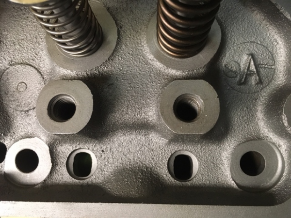

If you pull the valve cover of & there is an large "A" cast in the valve spring area as in in the picture it is a 240 head. If you are the original owner you would know if it is the original head & block.
