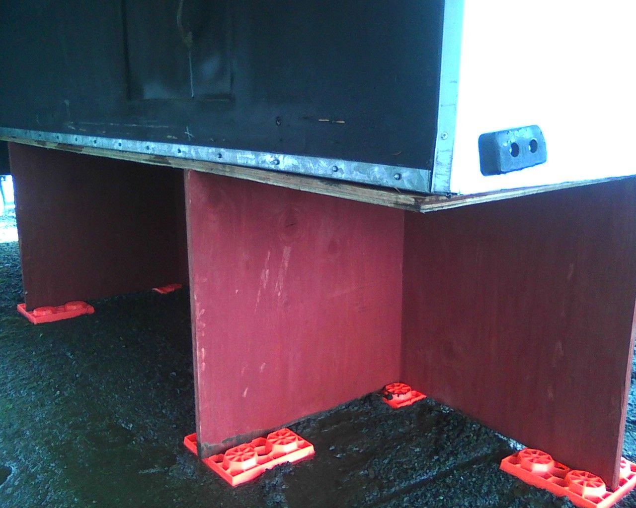

Found a pic of mine in the pole barn, I put mine up high enough so no critters can get to it and the extra thick pallet is just for additional support.

Is that rigid insulation? Pretty smart way to ensure there are no overloaded spots.

Yes - it's a scrap piece of 2in styrofoam ripped to size. Like you said it prevents overload spots (like the rubber mat in the truck bed)
