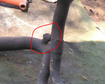

first pic-- is your O2 sensor that should be a mini H-pipe with O2 bung welded in, second pic-- I believe that piece is just to keep pipes from touching/rattling against each other, not a 2nd O2 sensor
mini H-pie and O2 sensor
stop touching/rattling against each other

Thanks for the replies. In the pics. The o2 sensor was screwed into the rear stop touching fixture. I confirmed both pipes are drilled, allowing the sensor to get exhaust gases. My harness feeding from the driver side wouldn't even reach for connecting an o2 sensor to the front opening. After Sunrise I'll test the O2 sensor for both these changes as it heats up. If my truck is only supposed to have one sensor, am I correct in assuming it would be a switching sensor since I do get a fault code saying it's not switching?
