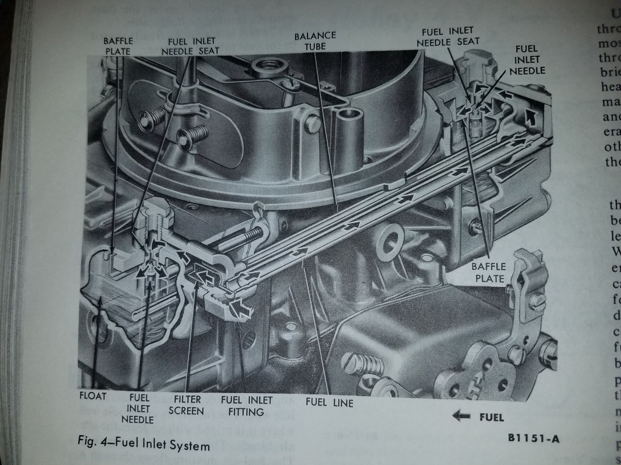

Hope this pic works...
it's the screw at bottom, just above the word "line" where it says "fuel line" at the bottom caption
I'll look for that screw when we're messing with it next. There's extra cables and lines attached to set the throttle for running the pumps, so things got a bit confusing on this one.
