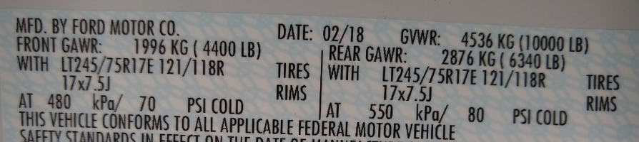

I have 5600lb front springs which I believe are the AD code. If you look on the sticker on the door jam it will tell you what you're axles are rated at. I think the trucks with the snow plow prep sit around a 1/2" or so higher in the front, which is why I went with them. Some say the truck will ride rougher but this CCSB with the plow springs rides quite a bit smother then the regular cab with 5200lb springs I had.
Old Sep 1, 2019 | 05:26 PM
JW20's Avatar
JW20
Joined: Aug 2019
Posts: 56
Ah, okay. Looks like mine is 4400/6340. So basically one with snow prep would have 5600lb where mine reads 4400lb?
Old Sep 1, 2019 | 06:26 PM
Cornbred's Avatar
Cornbred
Joined: Jul 2017
Posts: 123
Thats correct
