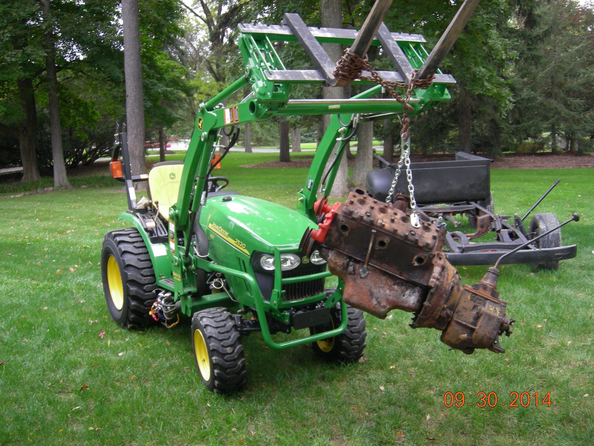

Wondering if anyone has any instructions or pictures of removing the 239 flathead. I'm taking out my motor in my 53' . Its equiped with a 4spd sync if that matters?

Not much to go on here.
It’s impossible to get the engine out without removing the hood.
It’s easier to remove the engine and trans as a complete assembly.
It’s also easier to remove the front clip and then remove the power train.
Are you rebuilding the Flathead or replacing it with something else?

It looks pretty straight forward. Im going to drop in another flathead for the time being. Current motor is stuck.
thanks,
I'm not sure what you need but here are some pictures. It is pretty straight forward removal but much easier with the grill and front fenders removed. Note that they can be removed as an assembly.
