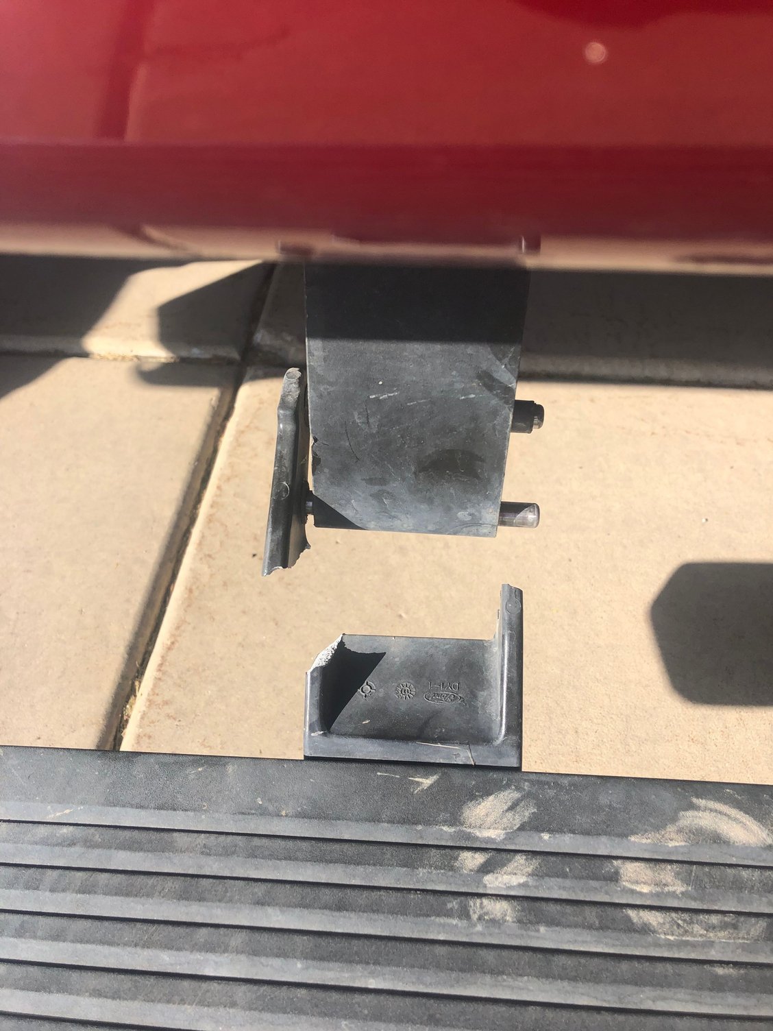

The rear bracket on my passenger running board has snapped. Running board is hanging by the front bracket.
Can you buy just one replacement bracket
I'm afraid I'll have to buy a whole new running board
I'm having a hard time finding the parts on the Ford Parts website

Is it possible to weld it for now?

You can just buy the bracket. HC3Z-16A506-B or 507-B depending on side.

I ordered the 16A506-B since it was my passenger side. But the website don't give you much detail on which side - which part number goes.
Online was about $100 cheaper than my local dealer.
I like to support local, but a $300 vs $200 is a big difference especially since the dealer had to get it in from back east and I'd be at least as long of a wait.
I'll limp around for a week with it broken and spend next weekend fixing it. Looks like 4 bolts. So it should be to tough
That's what I would have done. Looks like cast aluminum. An easy fix.
