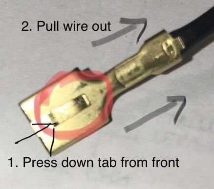

A quick update....I put in the new module. Still the same issue - no start but turns over fine. So, I went back and check my connections. As I was checking the coil connector, the green wire broke off. I ordered a new part. I also started a new thread about this problem - turns out I should have posted it here. Anyway, some one said that I could "unpin" the wires from the connector. How is that done, as it seems the connector is all one piece? If I could do that, I could restrip the wire and connect it.
Any thoughts?
Old Aug 31, 2019 | 06:22 AM
77&79F250's Avatar
77&79F250
Moderator & parts slinger
Posts: 50,096
Likes: 5,757
I believe the wires have a small lock tab and need to be depressed to remove them. Similar to this turning signal connector? Great thread to read up on. https://www.ford-trucks.com/forums/1...ch-thread.html

What Rich said. But with more access in a Ford coil connector than most to get that little tool, or a very small screwdriver or poker-thingy inserted.
Basically it's just a flat tab on one side (top I think) of the flat connector.
Hopefully I'm not sending you down the wrong path, but if I remember the steps would be like this:
1. Remove horseshoe connector from coil (slides off with a good pull).
2. Push the wire inward slightly (as if back towards the coil end) to pull the locking tab away from it's notch.
3. Insert tool from front opening (with these, you should be able to peek in and actually see the tab you'll be pressing on).
4. With pressure on the locking tab to flatten it down, at the same time pull on the wire so that the now-released tab can pull out.
Takes a bit of finesse sometimes, as you push the tool inward it tends to tension the connector in the housing. You can slowly release tension on the tool as you pull rearward on the wire and it will come out.
In theory...
If there is no wire left to grab, you can reach in with a small pair of needle nose pliers to do the pulling and yanking and fiddling.
Good luck!
Paul

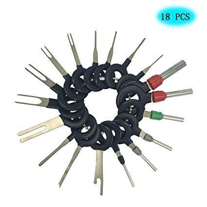

Something like this? A good tool to have just for that.
Amazon Amazon
