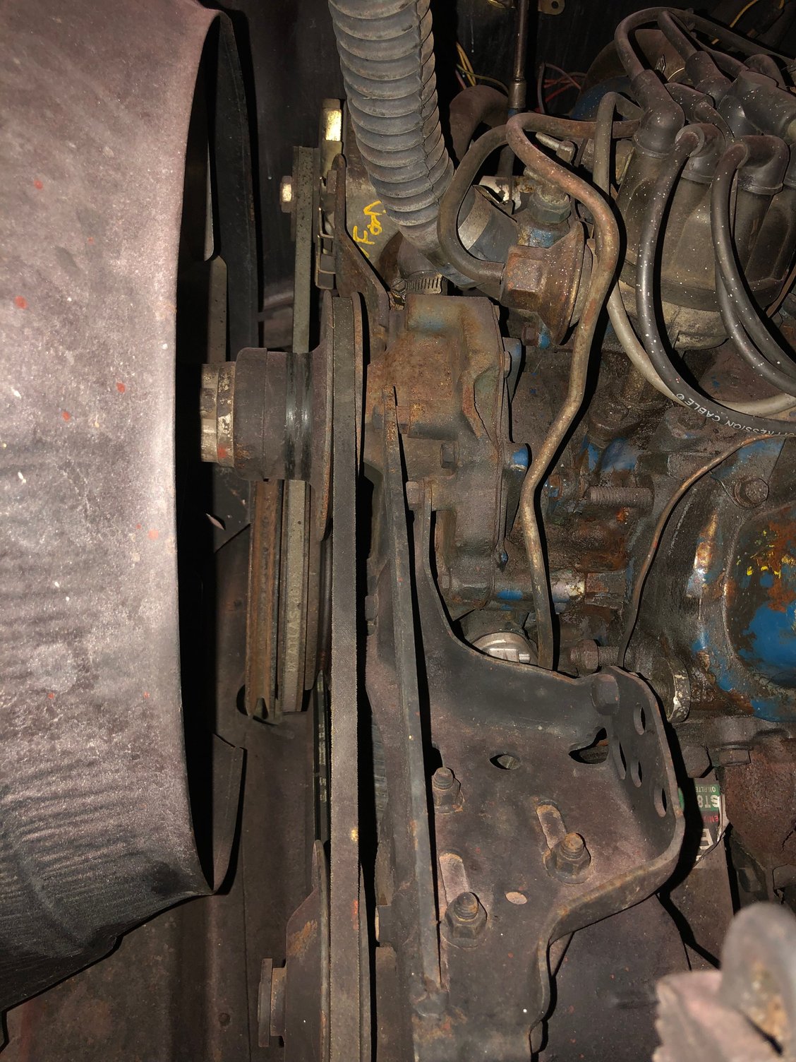

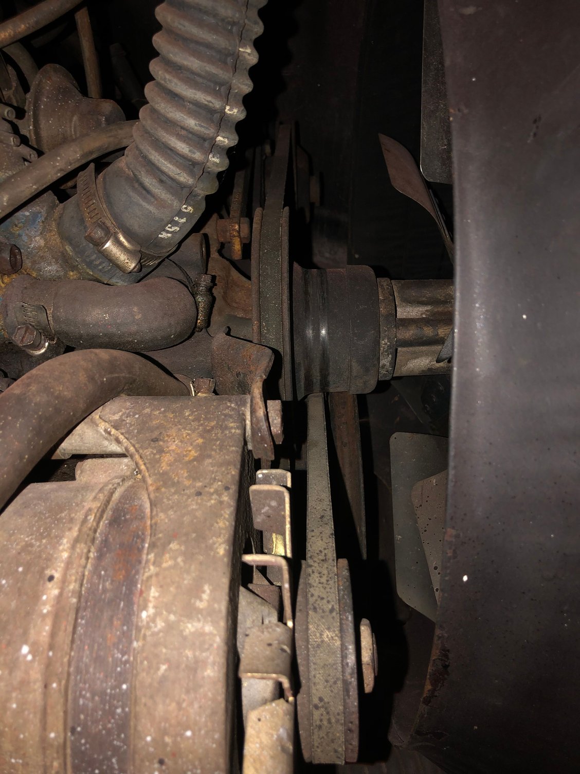

Well, the plot thickens... here are a couple of pictures. It appears I will need to find a 2 sheave water pump pulley because the water pump is currently running off of the rear crank pulley with the useless P/S pump acting as a tensioner. The single deep pulley for the water pump will not work. The pulley currently on there measures right at 3 inches from front to back and I need a v pulley at about 1.75 inches to catch the alternator and crank pulley. There is no easy way to move the alternator back to match. Pardon the messy motor, it will be cleaned up! Just starting this project (it does run well).

What you need to be looking for is a double sheave water pump pulley for a 302 from that early 70's era. This one piece is all you need to change. They can be found on a number of early 70's Ford applications.
C6AZ-8509-A .. Double Sheave Water Pump Pulley - 5 7/8" O.D. Marked: C6AE-8509-A / Obsolete
Misc 1966/72 FoMoCo 302/390 Passenger Cars // 1968/76 F100/350 302/360/390 // 1969/74 E100/300 302.
MUSTANG'S ETC. in Van Nuys CA has 1 = 818-787-7634.
MUSTANG SERVICE CENTER in North Hollywood CA has 1 = 818-765-9266.
