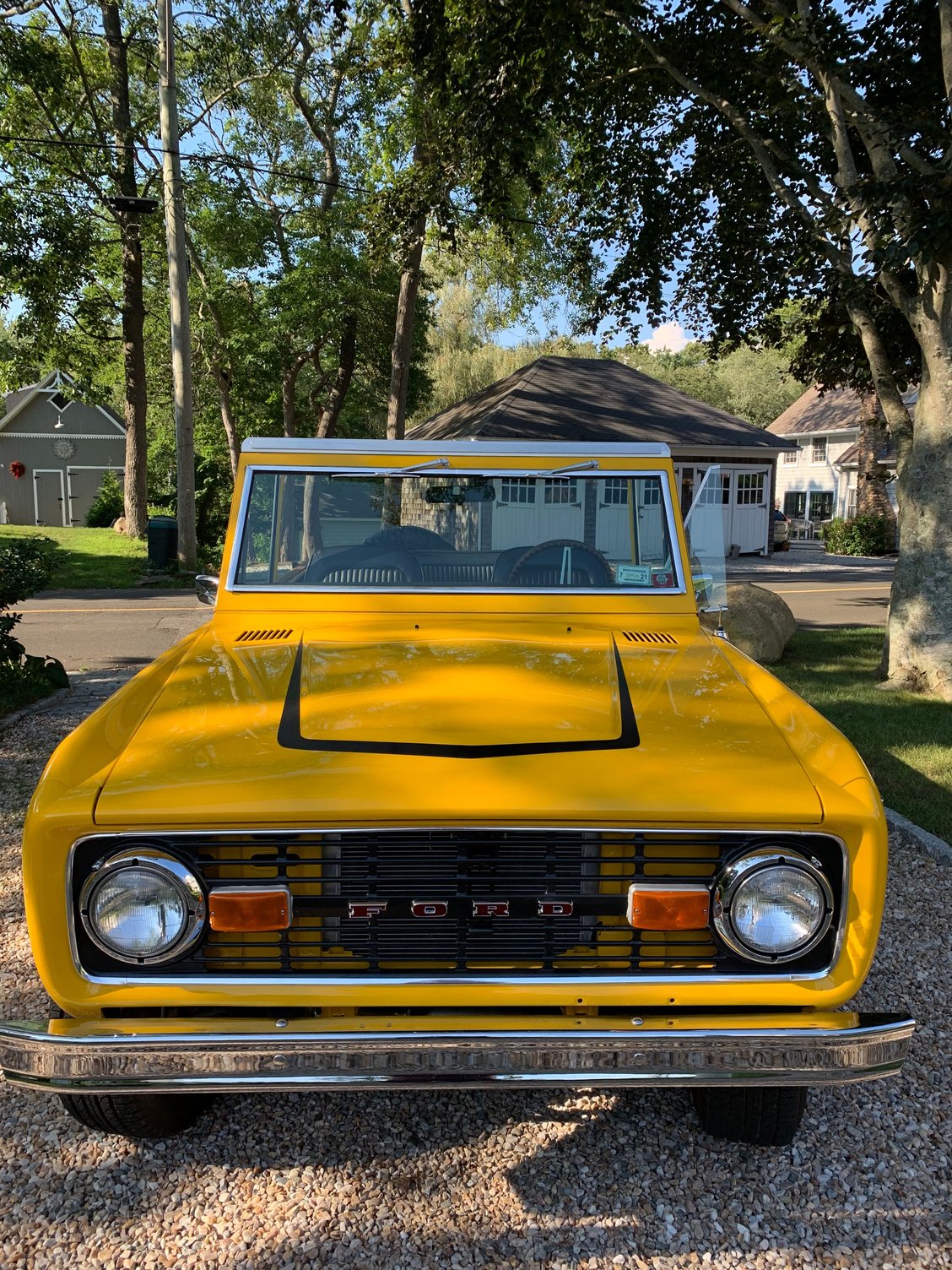

Hi folks, I just purchased a 1976 Bronco and need some help. The truck runs well until I run it for a while in 3rd gear. The Bronco starts to cut out - like a fuel filter issue - but I just changed the fuel filter and the issue is still happening. It’s episodic - sometimes it runs fine, sometimes it starts to cut out in 3rd gear. Any suggestions?

Great looking Bronco by the way. What all has been done to it? Maybe it's an ignition coil or ignition module cutting out with heat, or if the stock Dura Spark setup has been changed to something else, maybe it's acting up.
