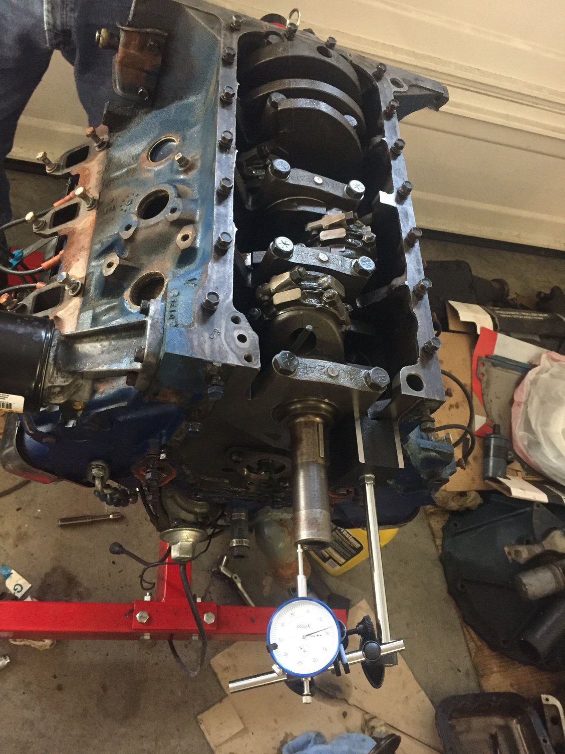

So I finally got around to installing the new bearings, I did polish the #2 main journal that I was questioning due to some bearing damage, everything else looked perfect. I will say that I went through and put everything together and went to check the end play and could hardly get .0015” out of it, so I loosened the thrust cap back up, worked the crank back and forth then pushed the crank towards the front to simulate clutch pressure and torqued it down, boom .0085” of end play, right on the money. Spun it over several times and pried it back and forth a lot and everything stayed put .0085” of end play still. So I guess there is some validity to the method above, thanks for the advice, I really enjoy learning new stuff. Now I just gotta hope the rear main does not leak!
