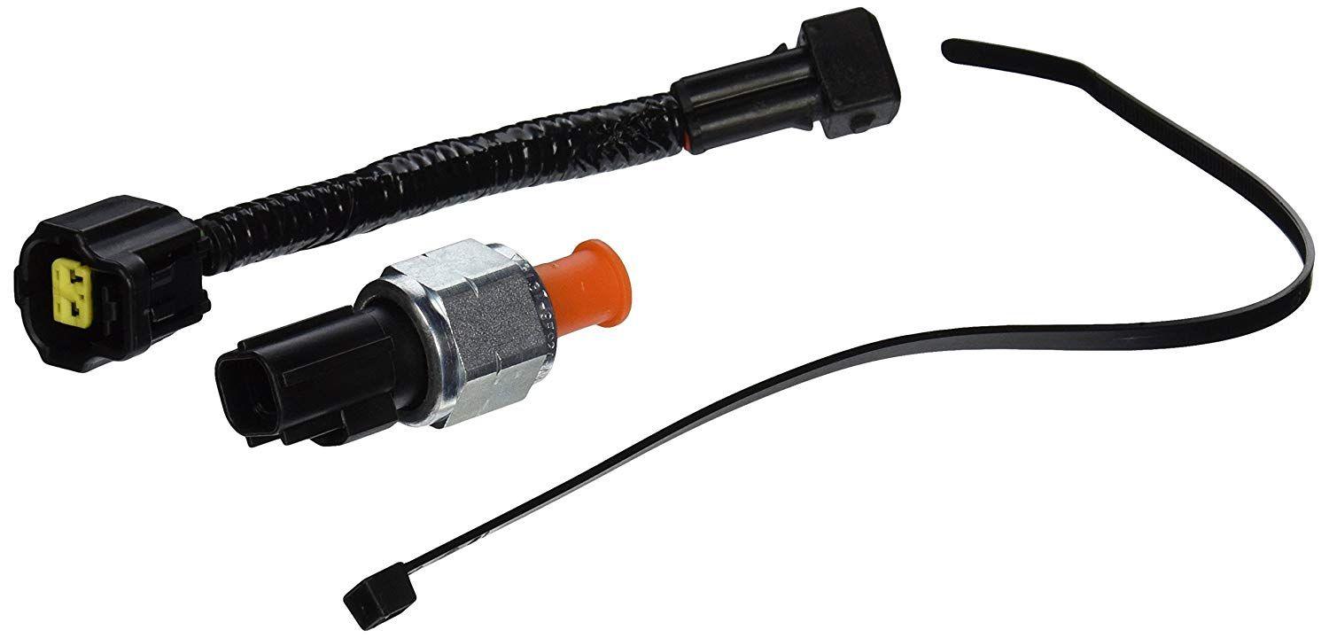

Ok, I'm stumped. It appears the issue on my cruise control not coming on may be a bad brake pressure switch. On an 04, the switch was right in front of the brake fluid reservoir. On the 06, it's not anywhere near the master cylinder that I can find. Anyone know where it is?

Under the reservoir.
If that's not it, or if it's a manual trans, check the clutch pedal position switch. I know older models they recalled the brake pressure switch, in the location you mentioned, due to a fire hazard, but I don't know if they were that way on the 04's or not. Would not surprise me.
The pressure switch was eliminated starting with the 04 NBS F150s (Note: The 04 F150 Heritage models still used the brake pressure switch). It was replaced by a mechanically activated switch mounted to the upper brake pedal arm. Look for a blue and white switch.
The video in the preceding post is of a Super Duty, not an F150. Different schedule on the transition. The SD trucks still had a pressure switch on the master cylinder through the 2010 MY.
