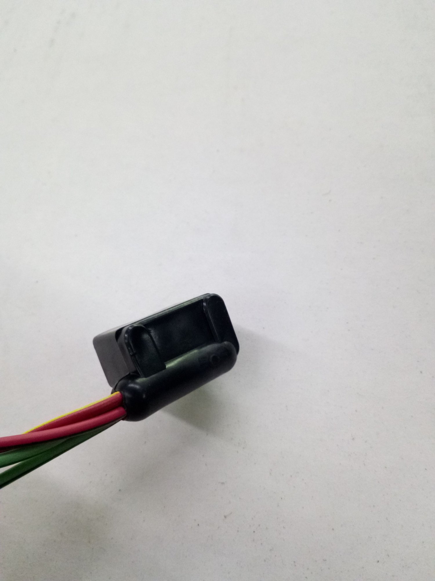

In my mind if the connector is that loose, you risk not having headlights. Also a non oe connector beats an electrical fire any day.
Not sure what year your truck is, but your rubber body is a little different than a 61 and 64 harness I have handy. For what it's worth here is what is molded on my new repro 64 harness. I think I bought it from Obsolete but it is made by Bauer.
Pin side
'back' side
I haven't installed this harness yet but so far I'm very satisfied with the quality of the molded connectors and it lays well compared to the old used harness.
