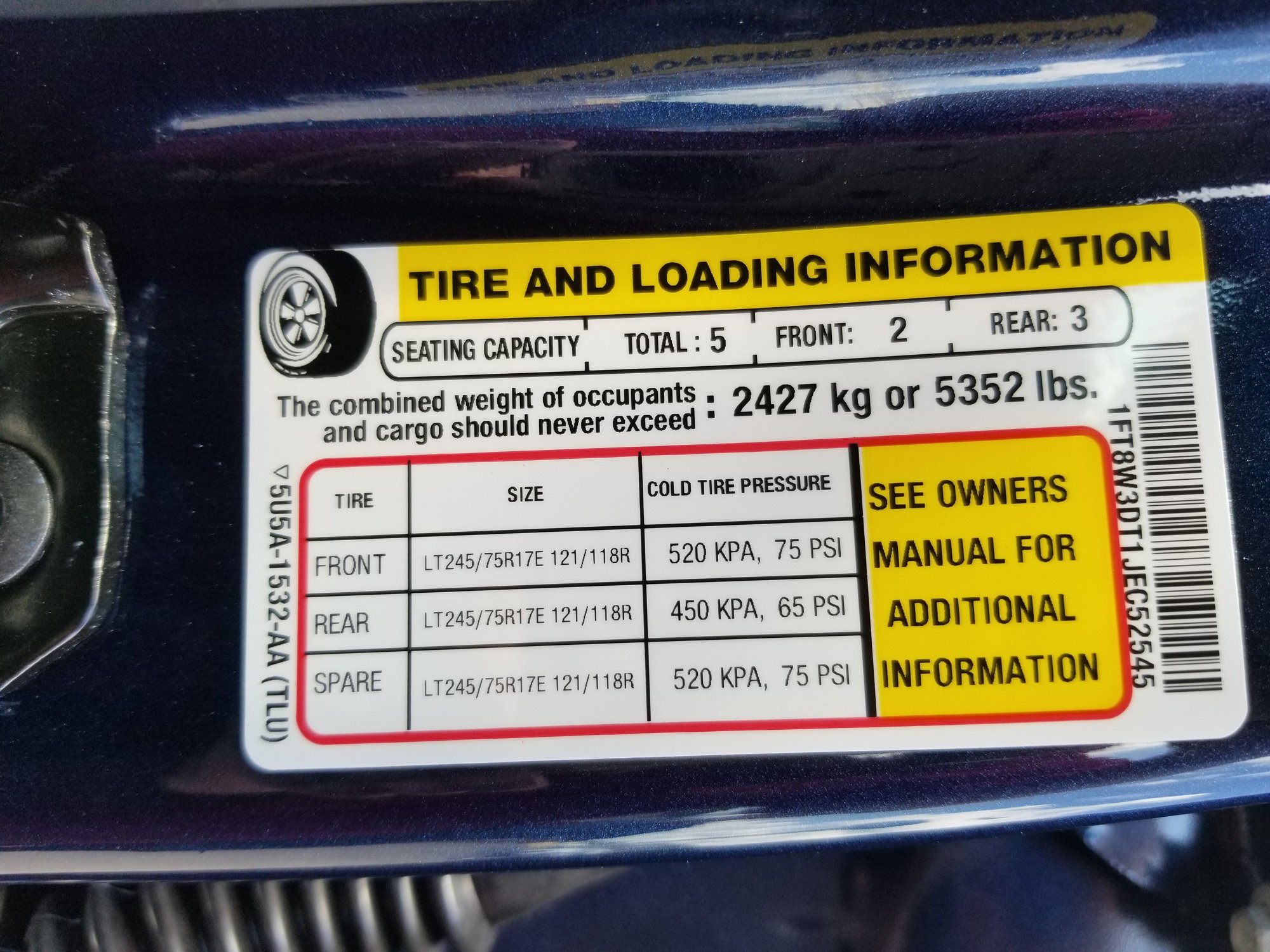

A fifth wheel needs a minimum 20% of its actual weight on the pin - this is for stability while towing it down the highway. Actual pin weight will always exceed the manufacturers on the lot spec number.
Figure 25% of its gross maximum to determine if your truck is capable. 26,500 is a tremendous fifth load; 25% of that is 6625 pounds (significantly over your provided numbers). A terrible mismatch!
I'm surprised by those F450 numbers, here's my (dually F350) weight sticker (5352 pounds):
