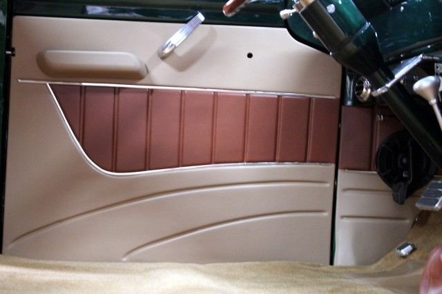

I have the embossed ones and put speakers in them but the weight of the speakers is too much for the Velcro fasteners. Would be no problem without the speakers added. I had to cut more out on top of mine because of the dash extension I made..

Those look great. We’re you able to use the clips?

I did use the Velcro strips at the door post location but because the way they are formed they don't hold so well but mainly do to the weight of the speakers. I'm going to build a flatter spot on the back where it contacts the door post so the Velcro makes better contact or I may have to resort to using a screw at the lower triangle gusset
