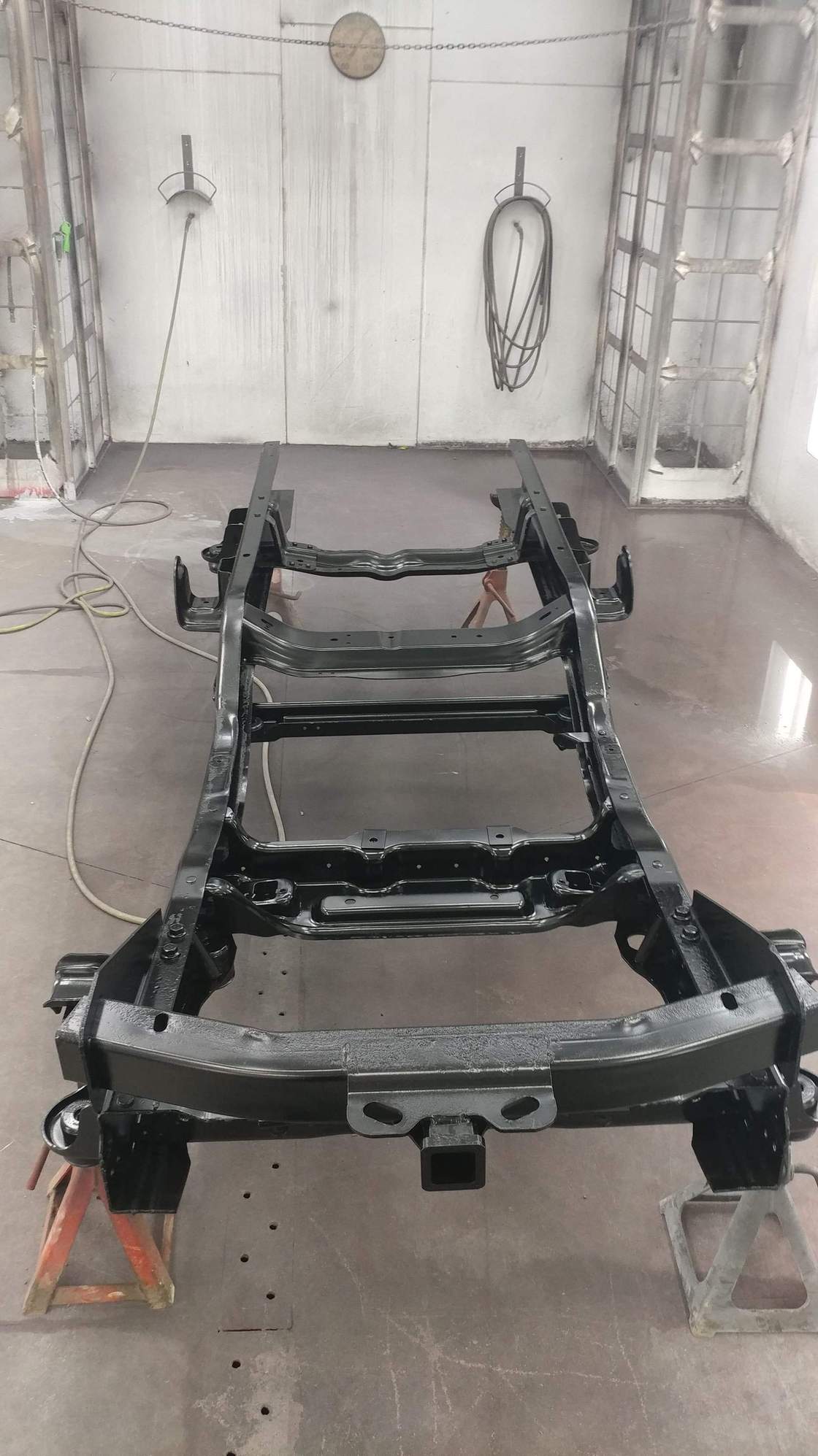

Old Aug 22, 2019 | 09:59 PM
dougger222's Avatar
dougger222
Joined: Mar 2004
Posts: 751
Likes: 11
From: May Township, MN
Modified frame painted.
F250 front back on the frame.
Body getting ready to be welded.
Looking like an Excursion again!

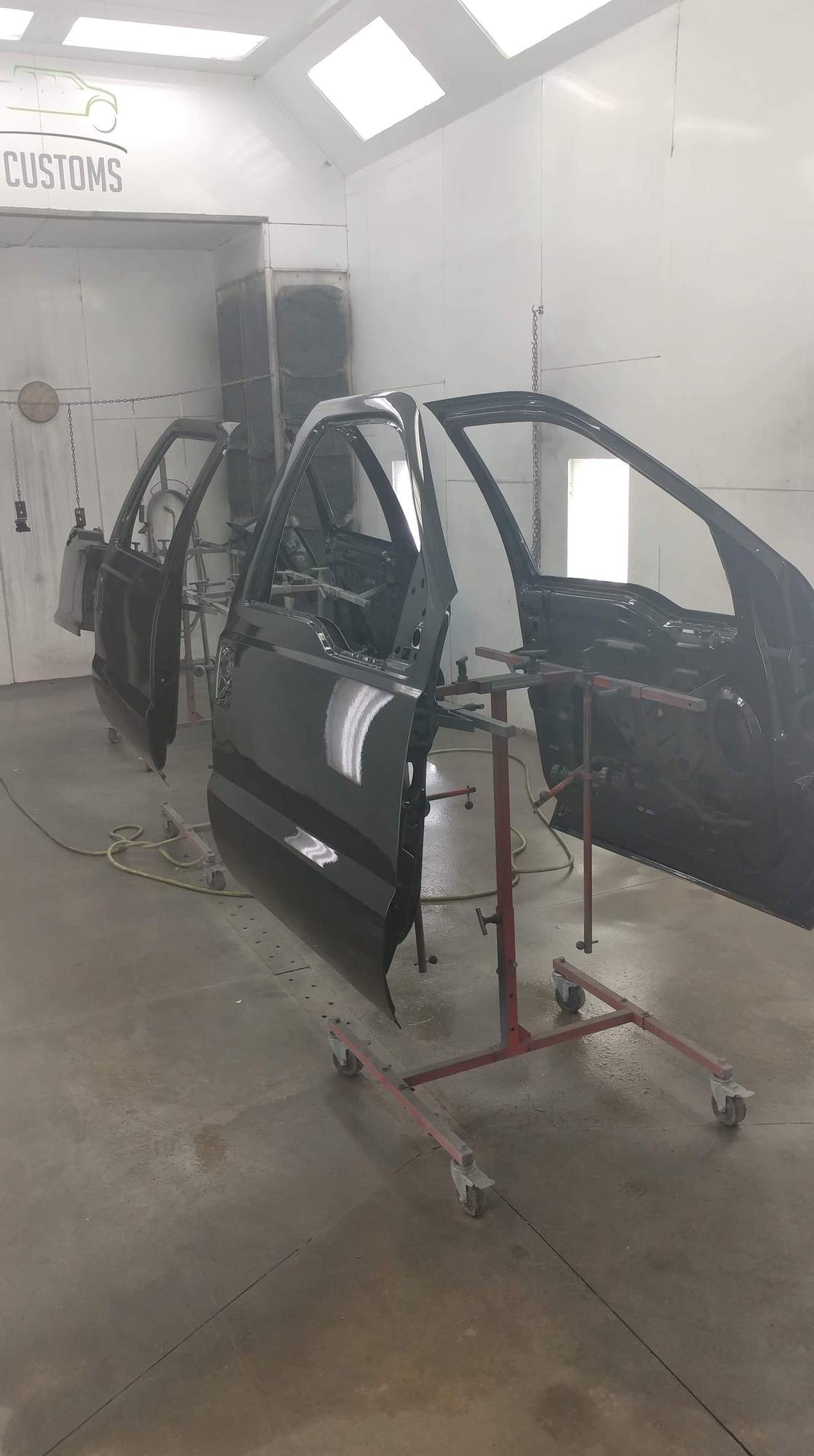

Old Aug 22, 2019 | 10:07 PM
dougger222's Avatar
dougger222
Joined: Mar 2004
Posts: 751
Likes: 11
Tuxedo black!
Rockers rino lined.
