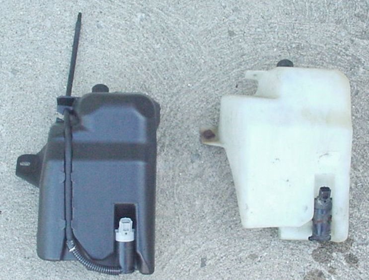

Testing the existing pump should be easily enough done without removing a thing Position yourself some where near the installed washer bottle/pump is located and have a helper cycle the wiper washers, engine off and in a somewhat quiet space. If the pump is working it will make a noise. If you're unable to access the connector for the washer motor---here's a photo of the uninstalled washer bottle/pump:
I don't know if your RV is a cab/chassis with added living space or if the entire body is made by the RV manufacturer---if that's the case these components might not be in the same location as I'm talking about. On the typical E-Series full body the pump and connector is at the bottom of the bottle nestled just slightly above the steel inner structure or wheel well---I don't know of any way to access the connector terminals with the bottle/pump still installed.
This photo is another view of the washer bottle pump connector, the washer bottle pulled upwards so its not sitting in its final location. As can be seen its necessary to remove the battery and tray for access IF your RV is an E-Series full body or cab/chassis.
