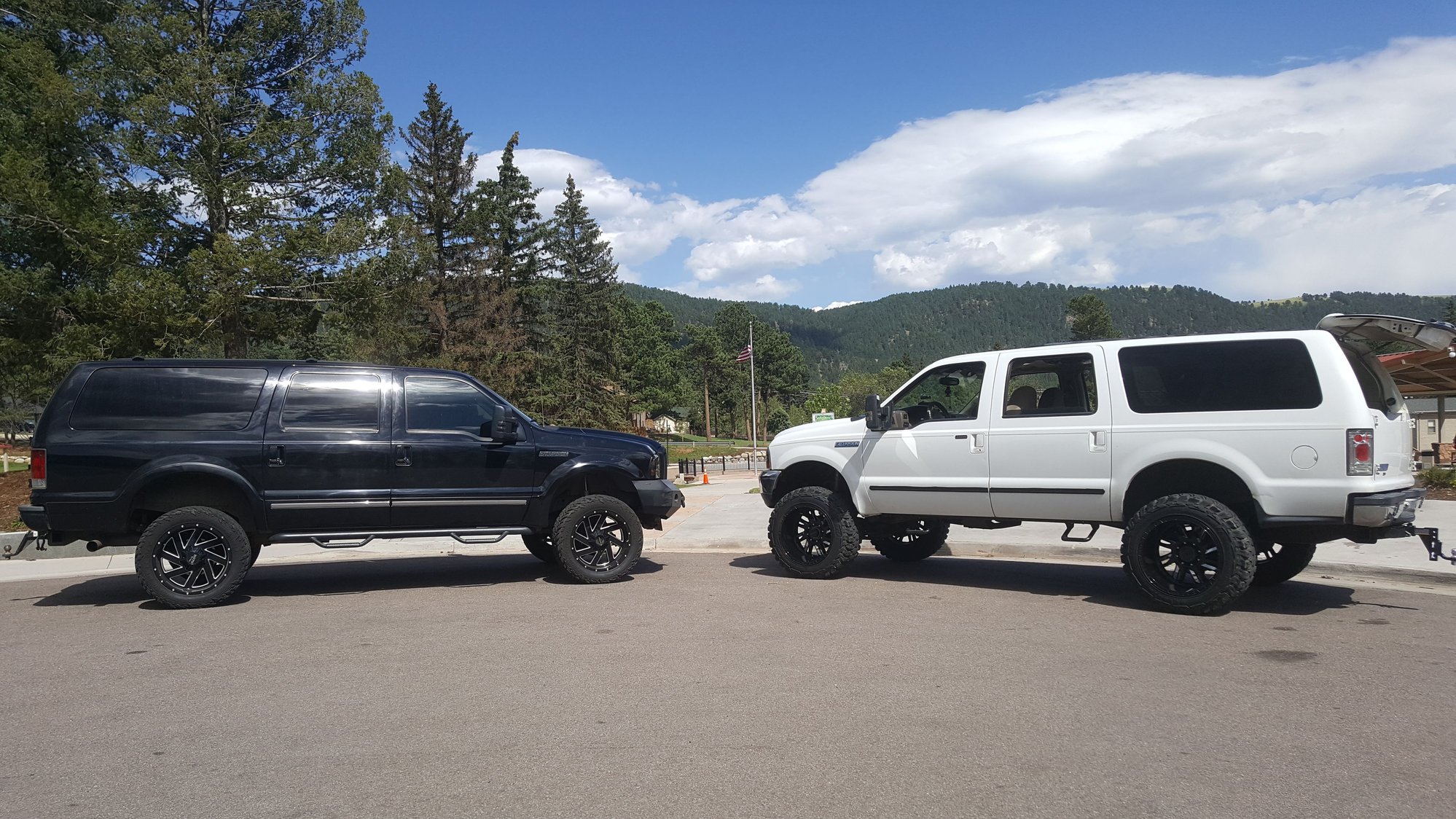

If your buddy's truck is either one of those two pictured, it isn't riding on the original springs (maybe rears with more block), both rigs shown are lifted.
^^^This

Mine is black
Mine is the black one and my buddy 's lift is all blocks

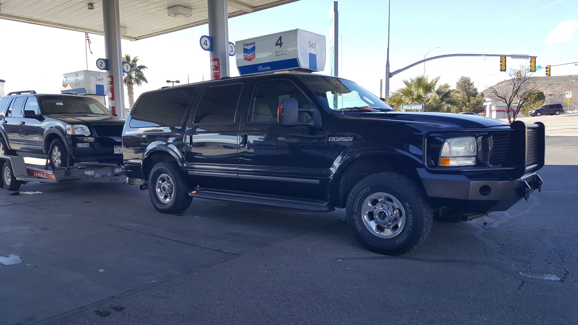

Rear Blocks and front shackles on my buddies truck. I went with RC 3 inch springs in front and ProComp F250 springs in the rear.
Here's a BEFORE shot running on bald tires. Just purchased it in Vegas
