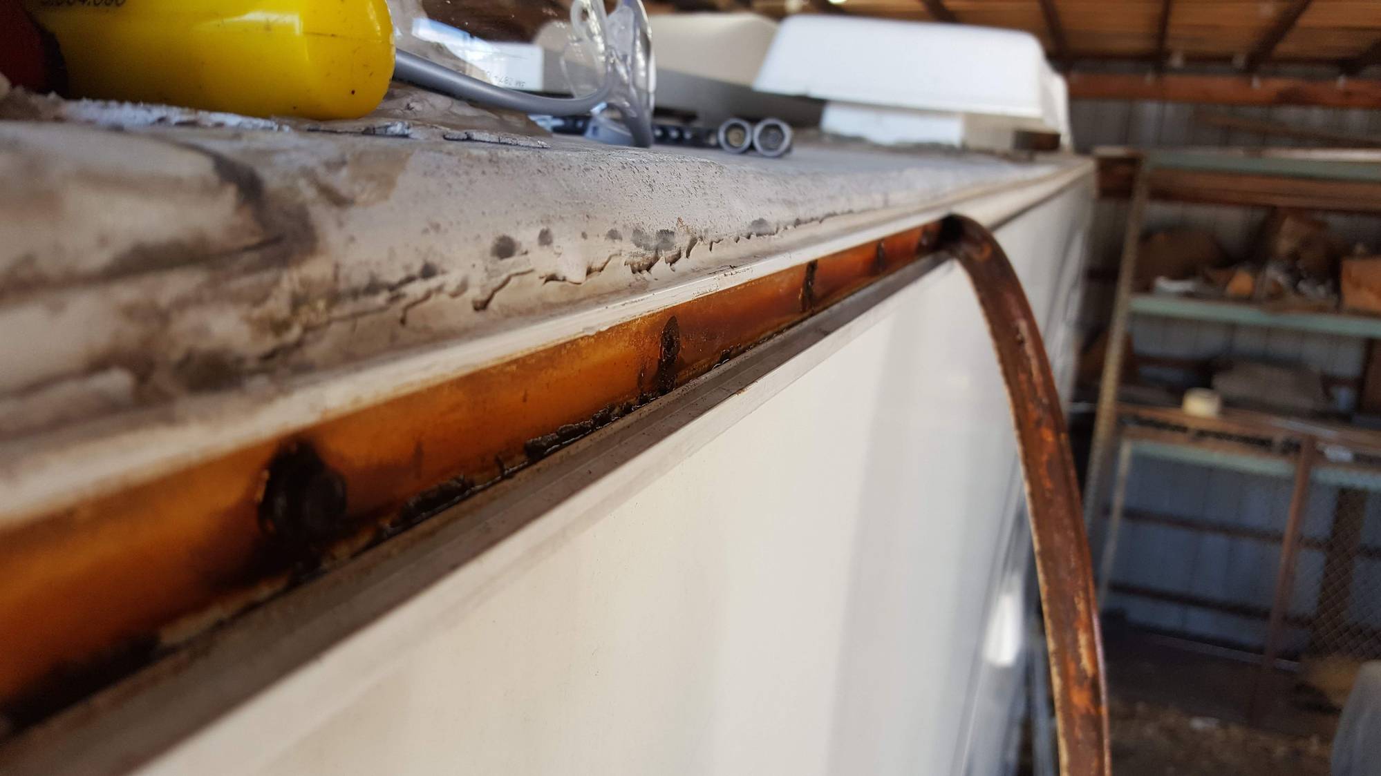

In this picture, I had just removed the screw that closed off the end of the vinyl trim. Water came gushing out. Well, not quite gushing, but I was surprised at the amount of water held in by the trim. There is still a drip of water on the downspout, which is almost worthless. For some reason, I thought the vinyl trim insert would keep the water OUT.
In this picture, I've peeled back the vinyl trim insert. As you can see, there has been significant corrosion taking place. The further back I peeled the vinyl trim insert, the cleaner it was with no corrosion about 2' back. The first few screws I removed were rusted badly. The roofline of the trailer is not horizontal. Instead, it slopes down toward the front of the trailer.
In the above photo, notice the caulk line above the molding. It's almost worthless. What you can't see is the caulk line below the molding. It was in almost pristine shape. I have to wonder if the caulk on the bottom of the molding was detrimental because it was holding water in. Drilling a few holes in the bottom of the area where the vinyl trim insert goes might go a long way to keeping the area behind the insert dry.

I've always considered the vinyl trim insert as cosmetic. The real protection comes from the butyl tape underneath. From the pic you might want to remove the trim rail itself and check for roof/wall damage behind it.

All the vinyl trim does is cover up screws, I would remove the gutter and make sure its sealed with putty tape, I would use screws from metal buildings that have the washers on them when reinstalling the trim.

I'm in a time crunch, so removing the entire gutter isn't going to happen. The rest of the wall is OK, it isn't showing delamination. I will be recaulking the gutter. I'm not looking forward to removing the old caulk there. The EPDM roof comes down under the gutter, so I have to be really careful to not put a hole in the EPDM.

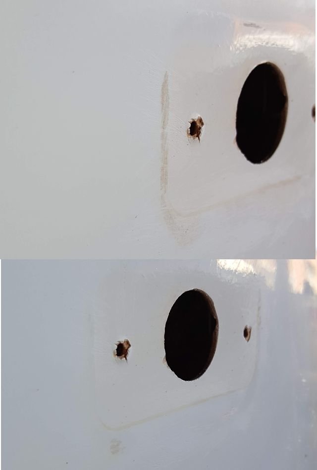

I have a big rubber block that is used to clear debris out of sanding belts. I tried it out on the silicone residue tonight. It takes a lot of elbow grease, but it does take stuff off. Well enough that I ordered a $10 eraser wheel. But what really worked was Xylene. It's nasty, stinky stuff, but it cleans up the wall quite well. On stubborn silicone it seems to soften the silicone well enough that it comes off with a straight blade razor (aka paint scraper).
Here are before and after pictures when using the rubber block. I used the rubber block only on the vertical line of caulk located to the left of the hole in the wall. I cleaned it up a but with a quick wipe of a cloth with a bit of Goof Off on it. It looks much better, but it wasn't worth the sweat.
