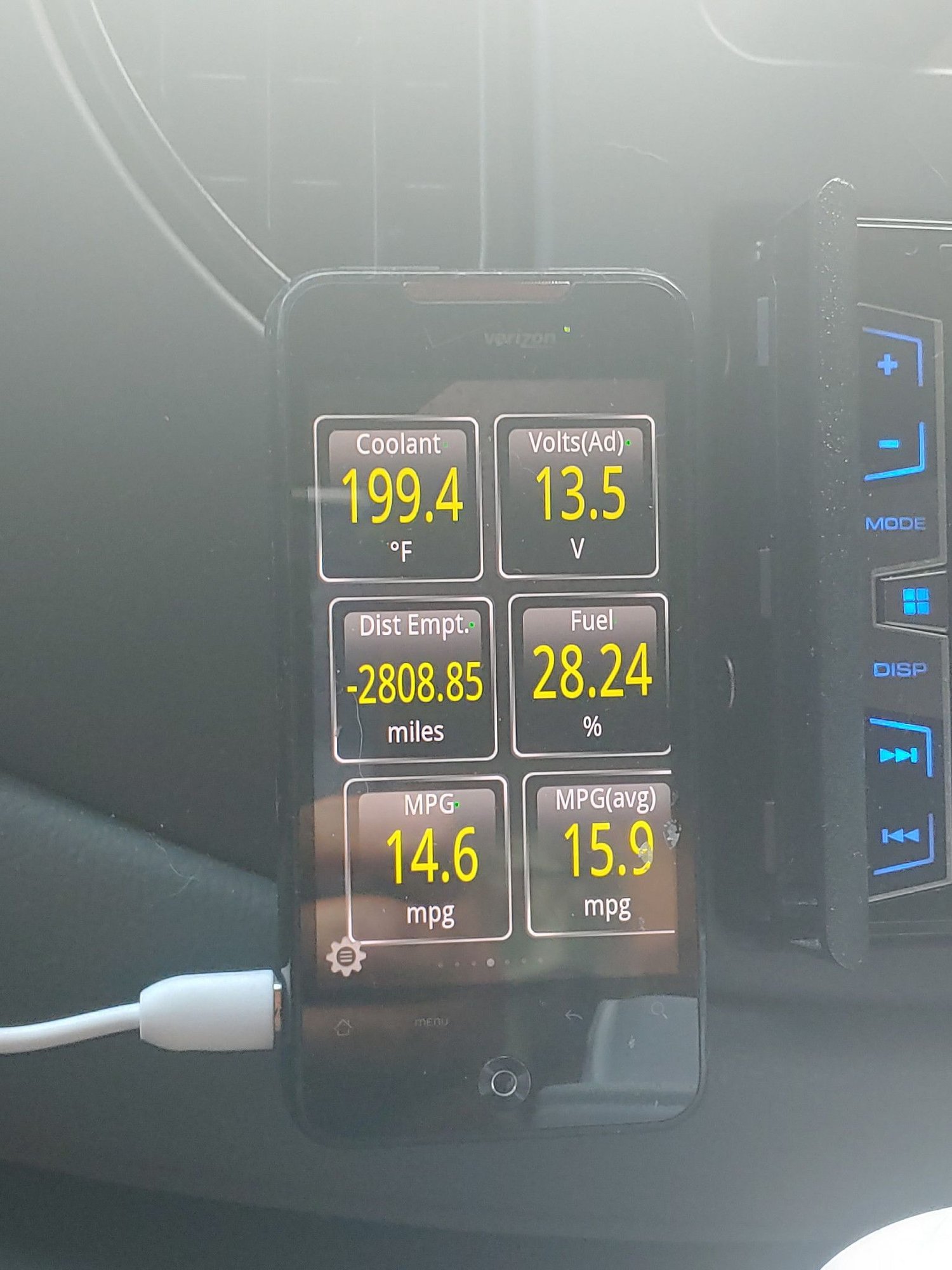

Here's 2 tools I've also found useful this trip
Haven't been able to get the distance till empty to reset though

What phone app are you using? 15.9 mpg? That's great for a road trip. E350 5.4 liter?
It's the torqure pro app. I'll have to calculate my receipts and mileage to confirm but i have a 6.8 E350
Damn, I average 12.8 with my hightop extended with a 5.4L.
