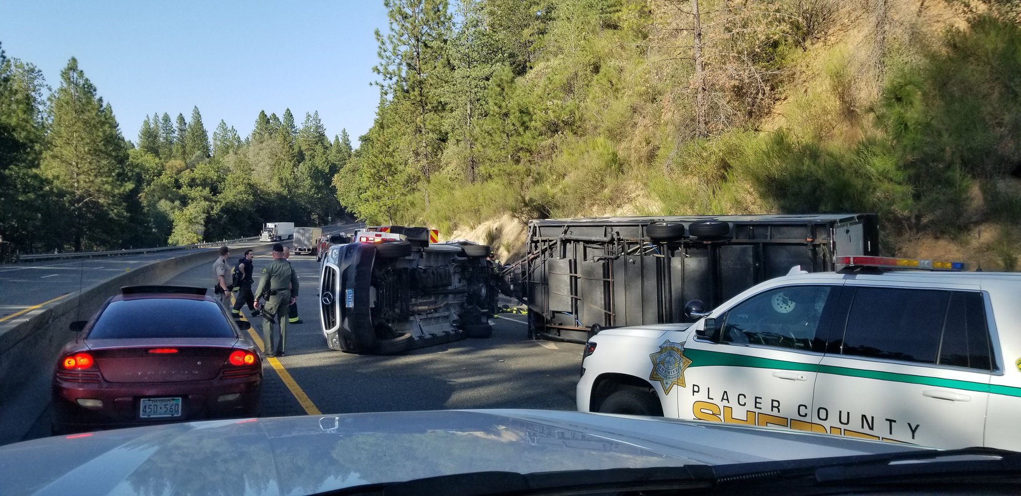

Most recent example on my way home last week from working with my son for a day in the Sacramento area. East bound Hwy 80 just past Applegate, CA.
Lots wrong here but worst of all was braking too hard in a corner and not paying attention to what the trailer was doing.
